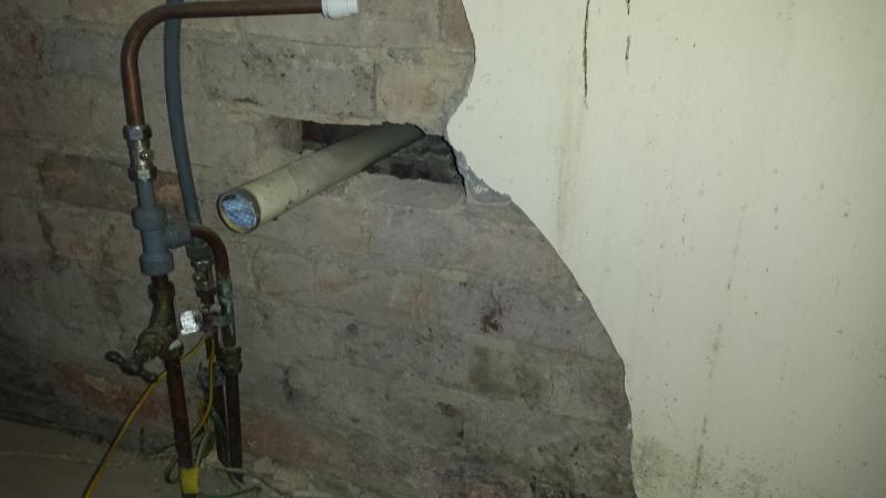

Hi,
I am in the process of redoing my kitchen, however upon removing cupboards I found the old render was crumbling away from the wall. I have removed the loose render and found the following.
So to repair this, am I correct in thinking apply pva, then plaster undercoat?
Should I use normal PVA or one with waterproof?
Also, the missing brick, where the pipe comes through is this normal? Should I plaster around the missing brick or over it? If over it should I just place a piece or wood over it? Or something else? It is behind a cupboard so doesn't need to look perfect.
Matt
1. fill the hole with a couple of half bricks set in sand and cement. Allow them to set - dont use any wood.
2. Cut back your wall plaster by about 50mm from touching the solid floor.
3. Having first removed any loose plaster, square off to ruled lines the patch you have opened.
4. Do not use any kind of PVA, simply take the suction out of the wall with a little water and scratch on a tight coat of sand and cement or sand and lime. Then float out a coat of S&C, and finally, after the float dries(24 hrs), skim over.
5. Is there a history of damp or remedial work in the kitchen wall(s) or floor?
I'd go with what Ree says, sand and cement scratch, then bring out with a coat of render. DON'T use gypsum undercoat plasters on old suspect brickwork/stonework. Any damp/salts will just come right through the gypsum.
