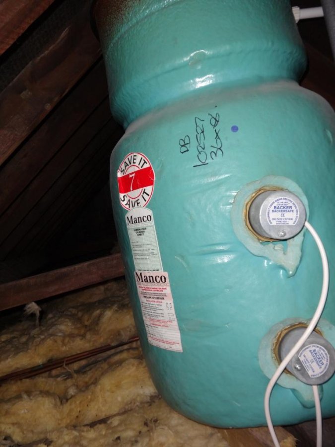

I don't know how old the fortic tank is in my flat. It has factory foam insulation, The youngest it can be is 7 years old but it could be more than twice that old.

OK I had a look and the tank Has blue/green insulation
Does the following information help to give an idea of the age of the tank and it's likely longevity?
A big circular sticker with "Save it", then a big number “ 7 “ in white font on a red back ground and "Save it" underneath
Then a sticker with
"Manco
Manchester Coppersmiths
BSS 3198 – 1981
Pure copper complying to BS 2870 used throughout
Brazing alloys to BS *45 (Zinc Free)
The bosses fotted to this cylinder comply with BC779 ( Parallel threads)
Max Heater length 355mm
Taper fittings must not be used"
Then
"Manco Vented cylinder/Combination tank commissioning certificate", which is not filled in. Obviously a very dilligent fitter.
In marker pen; DB 102527
The covers to the immersion heaters say:
3.0 kW 240V
2.76 kW 230V
BACKER
BACKERSAFE
CE
DO NOT COVER
Type: BS311
Made in England
Any clues on the age of the cylinder?
Its more blue than green
I see your difficulty. My blue one (current standard) is sky-blue. Let's see if anyone else can decide.
BTW I see it does have two immersion heaters, which is great. The lower one will give a full amount of hot water, the top one gives a smaller amount, faster. It is normal to run the bottom one, timed, on your cheap overnight tariff, and only to turn on the expensive upper one if you run out of hot water during the day. This is one of the points which, if I were you, would have pushed me towards upgrading to a new two-element cylinder, but you already have one.
I think it says "36x18" in marker pen, which is the height and diameter, in inches. Rather small for a bath but adequate for a shower.
It's not showing any signs of age.

Tanks should. easily last 25 years.
I doubt yours is more than 10 years old at the most.
