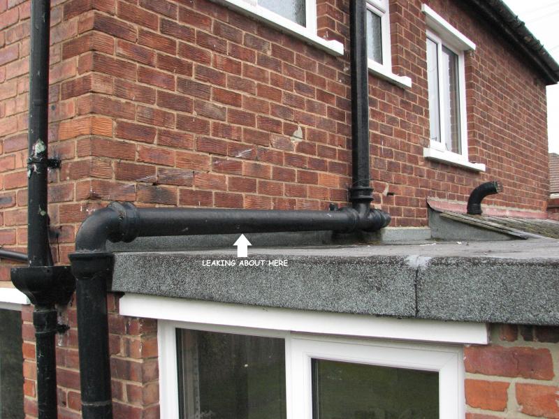

Here is a photo showing the middle section and where the leak is

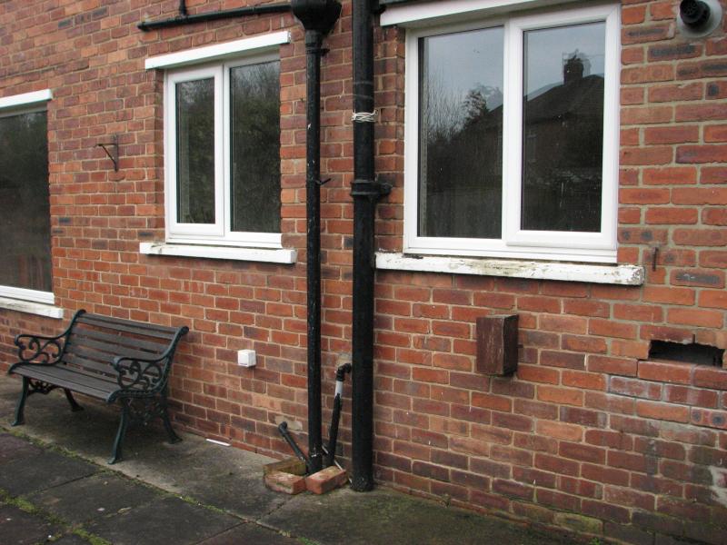

Here is a picture of the bottom section

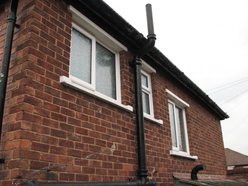

And Here is a picture of the top section.

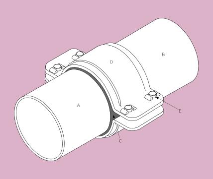

1. I believe there is something called a "timesaver" for converting from cast-iron to plastic. Can somebody provide a link to an actual picture of one? I've tried googling timesaver but all I get pointed to is an entire catalogue of plumbing items not the actual item itself.
2. I will be cutting the cast iron pipe with a diamond disc on my angle grinder. Do I want to be cutting as close to ground level as possible or I am better off making the cut about say 12" above ground level in case I crack the pipe while I'm grinding, to be honest the vertical bottom section appears to be in much better condition than the horizontal section (where the leak is).

TIMESAVER
Page 8
or one of these.
That is a timesaver fitting but why would you want to use that ?
Cut the cast close to the ground and use the fitting above.
Be careful as that cast is heavy.

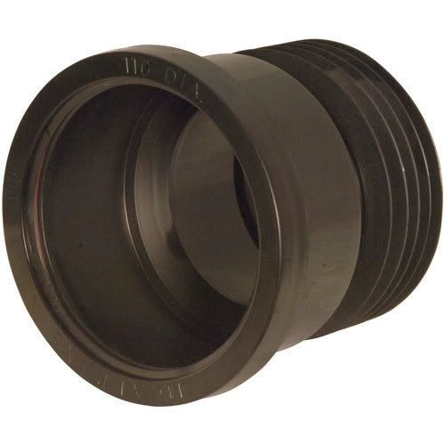

To be honest, the one you and seco services are recommending, ie this one
with its 2 push fit ends, looks a lot neater, simpler and is a lot cheaper than the "timesaver".
So why do so many people on here recommend the "timesaver"?
Here is one i've used but try and keep yours about 2 inches higher out the ground or the gestapo will be on to you saying that it shouldn't be in cement.....lol

When I replace the vent bit in plastic (as circled here)
I guess I need a couple of bits of straight pipe, plus 1 of these
and 2 of these to create the bend around the guttering
These parts are all push fits, so what stops them from turning and/or blowing off in stong winds, as they will be above the guttering?
Yes 2 offsets and a vent.
They can be a bugger to seperate at the best of times let alone turn or blow off in the wind.
Er.... Yes. :oops: (Was trying to multitask and clearly failed miserably.....)
No problem,
The one screwfix are calling the top offset says in the description that it's a push-fit to solvent weld, but the one they are calling the bottom offset only mentions push-fit. From your experience is the bottom offset also push-fit to solvent weld or are both ends of it really just push-fit?
To be honest I can't understand why these parts would be push-fit at all. I would have thought building regs would have insisted that anything above guttering and therefore not directly attached to the house would have to be entirely solvent welded.
Just bang some srews into the pushfit offsets to stop them rotating on the offset.
