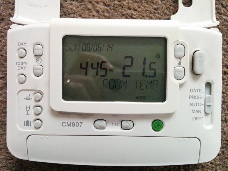

I've just moved house and I've brought my Honeywell CM907 with me:

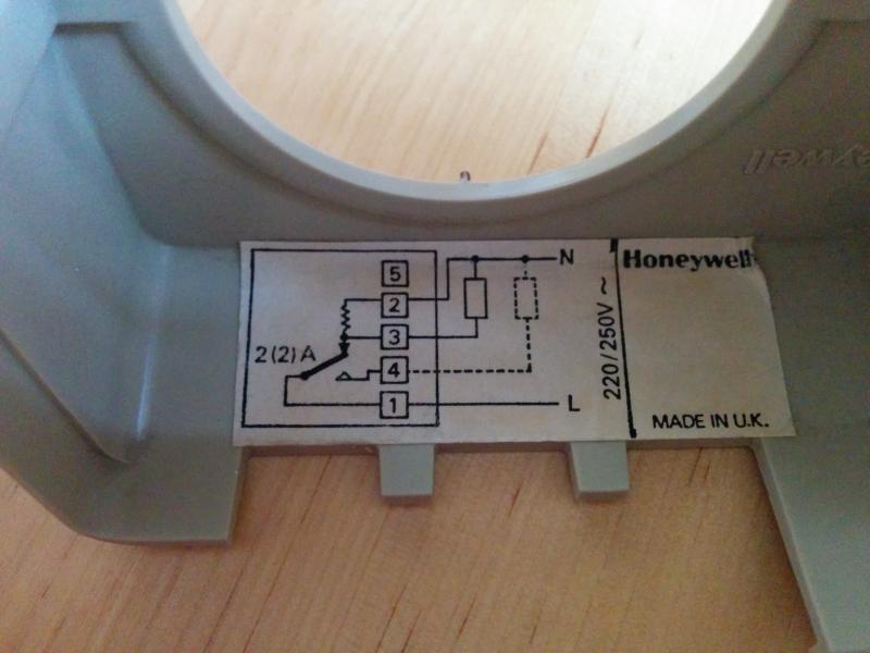

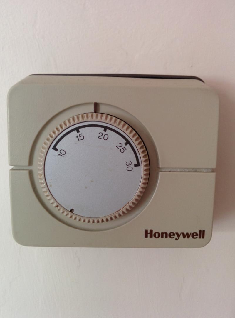

In my new house, they've got this Thermostat:

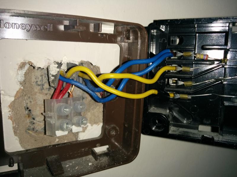

It's currently wired like this:
And the wiring diagram looks like this:
From what I can see, these are the connections:
Yellow wire (with black tape) - Terminal 1
Both blue wires - Terminal 2
Yellow wire - Terminal 3

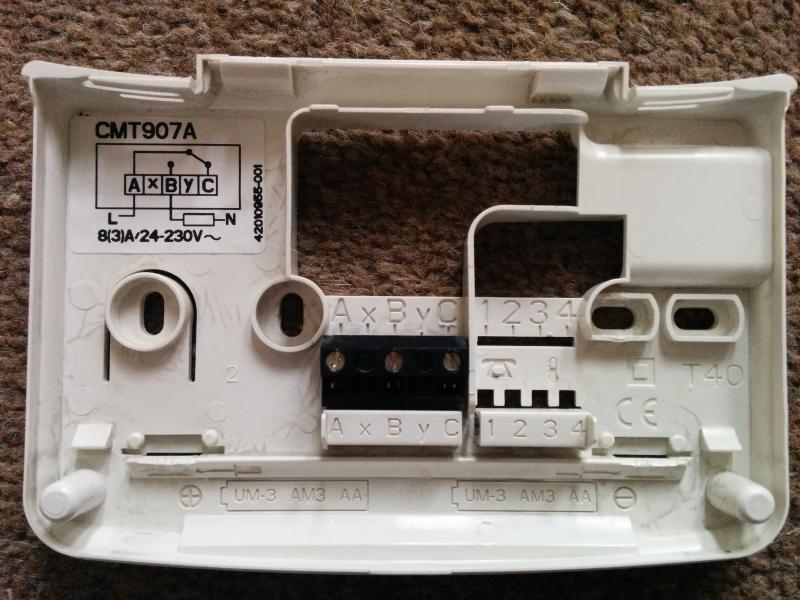

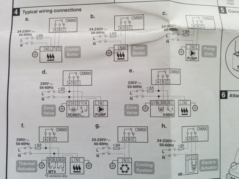

This is the wiring diagram for the CM907:
Could anyone tell me which wire should go to which terminal on the CM907 please?
I tried what I though it should be, but ended up blowing the fuse, so I'd like someone with more knowledge than me to take a look.
Thanks for your help.
Mark
1 to A, 3 to B and terminate the blue safely as not required.
Thanks very much denso13 - that was a really quick reply! :D
I've just tried out your suggestion and it works perfectly.
Thank you so much for your help, it was really appreciated.
