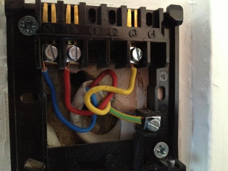

Hi. Want to replace my Drayton (RTS1) with a good digital one. I've attached my current wiring setup. Could anyone suggest a good digital room thermostat that I (a wiring novice) could install? Many thanks. Mike

The OP doesn't need to tell you what boiler he has! He has already told you that he has a RTS1 thermostat which, as you should know, is a 230V only stat. A quick check of the manufacturer's wiring diagram would also tell you that the wires are correctly connected: Blue to N; Red to L; Yellow to terminal 3, the switched live.
The Honeywell DT90E will do perfectly.
Connect Red to terminal A
Yellow to terminal B
Make the Blue and Green/Yellow safe; e.g stick them in separate holes of a small terminal block.
Terminal C is not used.
