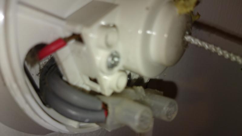

I need to replace a pullcord switch which operates both the light and extractor fan. I need help as to the type of the switch I need and the wiring. The old switch is wired as per the attached images.
On the switch plate you will have com/L and L1, red to com/L and black to L1, earth to earth terminal and keep the looped connection separate as it is.
