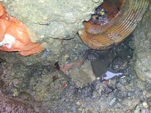

Sorry all, theoldun is right I am not clear in what I am asking and guess my terminology is completely wrong.

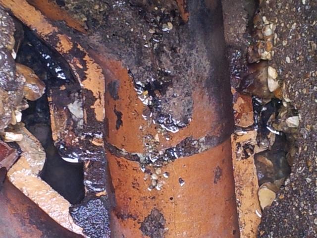

I have attached some pictures which I hope makes it more clear. The half cut clay pipe (think it’s the channel) has been exposed as it was evident from excessive water in the trench that it has been leaking.
My plan is to remove the complete unit (which consists of two connections, one to soil stack and one to gully) and preferably replace with plastic.

If theres not to much pipe work, why dont you replace the existing with a preformed plastic manhole, then renew the soil and gulley drains in plastic into new manhole.
It looks like that collar is cracked, so you wont get a connection to it. The whole lot will have to be removed into the chamber and replaced
You may be able to leave the chamber channel in-situ though and just connect to that - if you are careful when breaking the other stuff out

Whether you want to or not, you can't just "cement" a connection as it will move and crack and then you have a much bigger problem
If the pipe is intact, (just collar broken) you may get away with fitting a McAlpine DC-1 coupling into the clay socket, come away from that in 110mm plastic. If not i'd carefully remove the existing clay pipe into the manhole and fit a new piece of salt glazed pipe to get clear of the manhole, so it all lines up nicely without a 'lip' where solids can catch. You can then couple onto that with the plastic. Plastic has a smaller outside diameter than the clayware and will present a problem when trying to seal the hole left where the salt glazed has been removed.
Personally i'd use granolithic mortar to repair the benching. Use grano dust instead of sand in a strong mix, add just enough water to make it workable.
What you have is a 900mm bottom channel consisting of a 300mm LH 45degree channel junction, joined to 600mm LH 45 degree channel junction and an approx 60 degree three quarter section bend (slipper) which has a lump broken of from it, but will still perform.
Assume the inlet with the orange bag stuffed in it is upstream and this is the section you dug out and wish to replace.
Question. Where does this inlet run to and what does it serve? Is this inlet the one with the cracked collar? Is the first connection with the white bag stuffed in it still used?
Answer questions, will tell you what to do.
