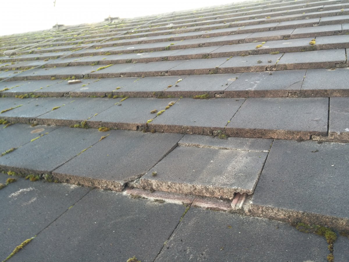

Roofer has quoted me £500 and another £250 for replacing 5 tiles and re pointing the Ridge tiles - around 12 or so.
Piccy
Thoughts? I think that's a joke to be honest, doable myself? don't fancy a Rod Hull moment though :(
Ridge tiles should not be re-pointed but re-bedded. Any "roofer" that says otherwise is not a roofer. If you are not happy with the quote then obtain other quotes.

P.S. you have another tile with a broken corner gutter two courses up.

I dont really intend to do the full job myself really bit scary but maybe I could swap tge main damaged tile out.
I was just mainlt after views on the quotes.

As Noseall rightly said, if the ridge needs attention then re bed them. Simply pointing will be a waste of money.
The tiles look like redland stonewolds and you will need a reclamation yard for these now.

I suggest a dry ridge system and a few more quotes

Does the ridge need work?
That could make the difference between a 1 hour and a 4 hour job, and the difference between the cost of ladder and scaffold.
Roofer came today, he replaced four tiles and re bedded one for £90 which is fair enough I thought.
He proceeded to tell us it would be £150 to re bed the rest but talked us through the process If I was to do it myself.
He then got me up on the Roof to show me! he told us the only way that tile cracked was by someone standing on it and funnily enough next door had work done to their Fascia's :(
