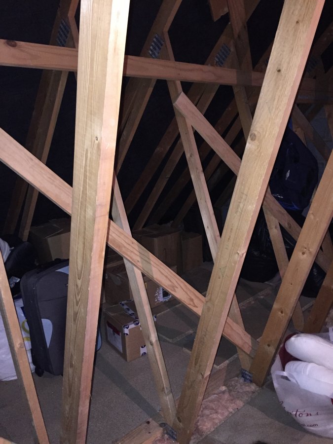

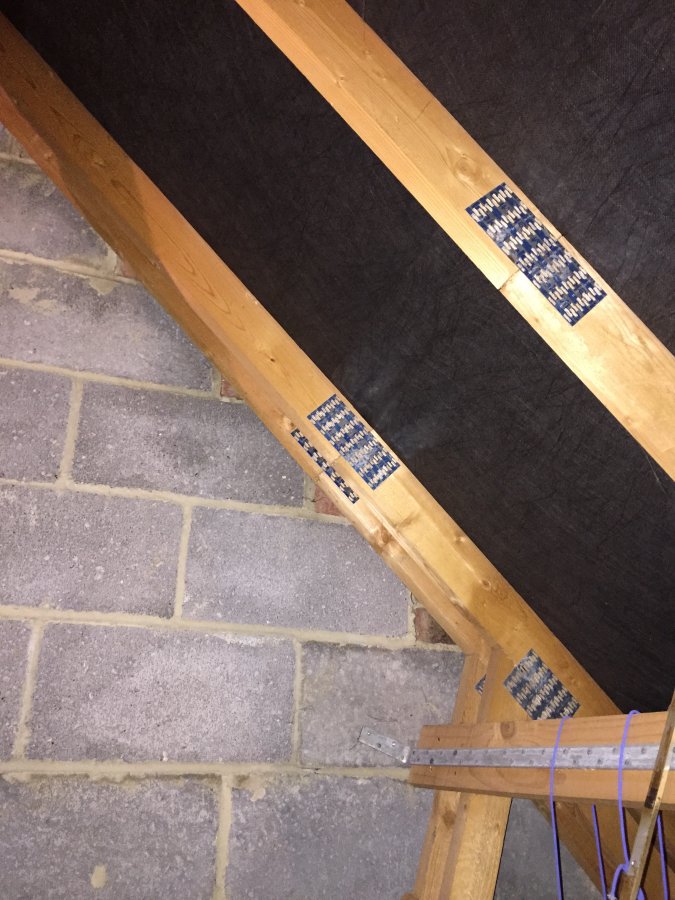

I'm looking to extend up into my loft and am trying to work out initially what structural work will need doing. I want to put a long flat roof dormer at the back and velux's at the front. The house is 10 years old so is the 'W' shape style. I'm aware of steels needing to go in etc, I've just been up there to measure up and I've realised that the rafters aren't one long piece of wood, there is one (95mm x 35mm) that comes down from the ridge and one that comes up from the wall plate and they are joined in the middle with the metal plates. If I did go ahead and get it done, would these types of rafter need completely changing before taking the middle supports out or is it "get around-able"? Many thanks

You have a truss rafter roof. None of that roof can be cut away. Not ideal for a loft conversion but doable with loads of cash and tons of steel and loads more wood. Basically you end up building a new roof and floor joists within the old one.
Hi, thanks for the replies I'm going to attempt to put some pics up, I've tried to get the whole loft in but it wasn't happening! There is no central wall so will be party wall to party wall and there are currently 10 rafters (2 against one party wall then 8 spaced at 600mm to the other wall).
You will either need to remove the existing roof and build a new one or get a structural engineer/architect to design you a method of adapting what you have into what you want using steel, new joists and new rafters etc. Much of the existing stuff will be bolted to new stuff allowing you to remove the 'W' bits.

Plus I have a separate roof pitch so additional loft with a lot smaller roof pitch as I have a walkway under our bedroom so the house is attached at the top but not the bottom, I'd like to see if I can knock a hole in the wall in the third picture and turn that space into a large "wardrobe / storage" space as the ceiling will be way to low to be a habitable room

Going back to your opening post Chris, if you're intending to put a long dormer roof at the back, then you're basically rebuilding half the roof. You'll need a steel at the apex, but it should then be fairly simple to insert a new rafter alongside the old ones, put in a temporary perlin for support and then cut out the trusses. I suspect the job may not be as complicated as it might seem.
