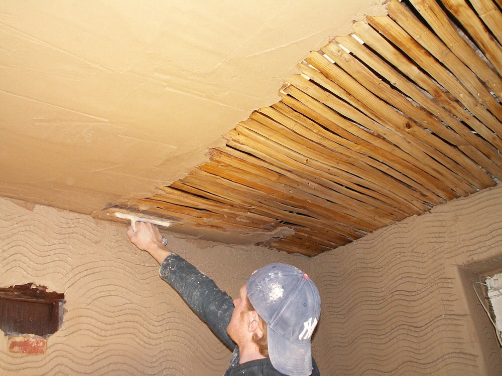

Any chance you can get access into the space above?
I don't want you to stress, but it might be your wooden ceiling slats that were used back in the days, when ceilings were plastered over.
If there is a build up of water, and the plaster is soaking it up, and taking the weight, and it's becoming a larger than normal burden, then you'll hear the nails 'popping'. The nails that hold on the slats.
I'm not saying this is the reason, but worst case scenario it is? And you see the water just sitting there above the ceiling? See if you can locate the lowest point where the water has gathered, and simply make a hole in the ceiling, and let the water drain into a bucket.
I did this last year, and I managed to save the ceiling above my bay widow, simply by pushing a long screwdriver into the plaster, after I noticed water 'dripping' in.
Fingers crossed it just movement because of wind ...
