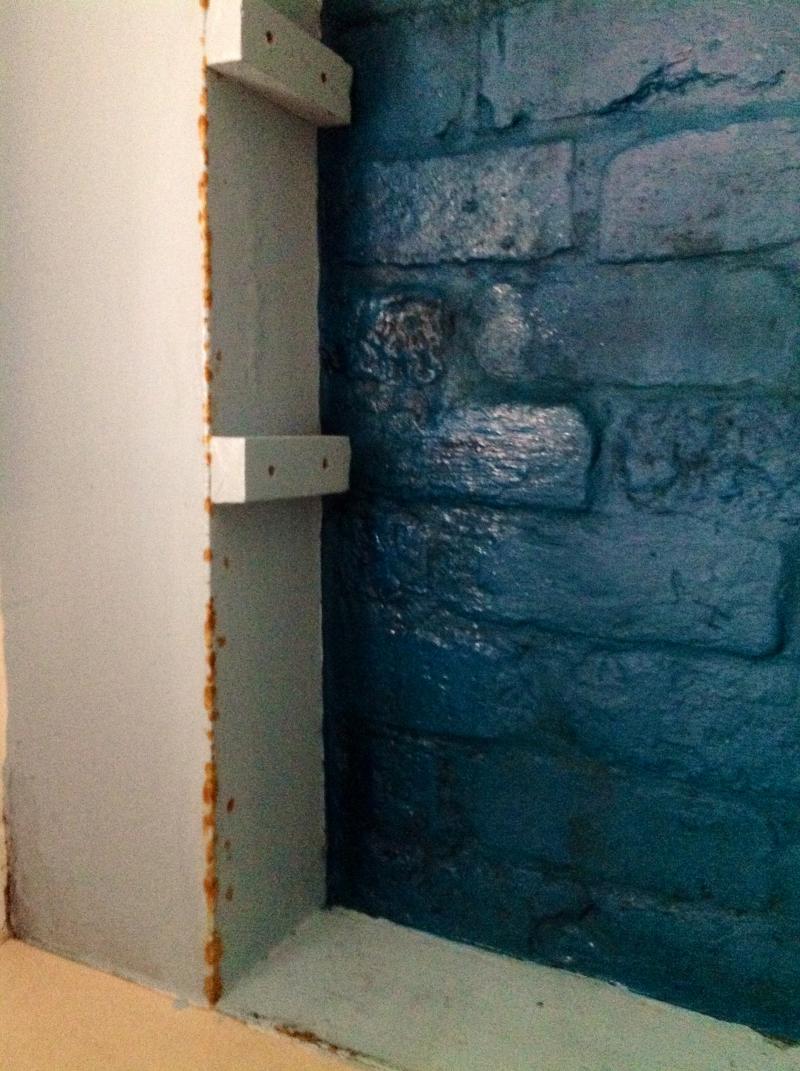

I have a corner of the kitchen that seems to always acquire black mold over winter. I am going to deal with it by putting a small dehumidifier there in future but my other problem is after painting the walls rust seems to come through after only a very short time. Is there anything I can do to stop this ? A kind of rust undercoat ? The light blue paint is a washable vinyl and the dark teal is matt. This alcove is a bricked up window to outside. Single cavity wall on terraced house.

The rust is coming through from the metal angel corner strip under the plaster, use a good sealing paint (Zinseer) ( or oil based undercoat) prior to Emulsion painting,
Wash off walls with anti fungicidal solution and apply Anti condensation paint prior to Emulsion paintng. I suggest Diamond Soft Sheen, (hardwearing and wipeable)

If the bricked-up window is thin uninsulated brickwork, it will be cold and attract condensation unless you insulate it.
You have to treat the damp, not just the mould.
