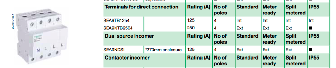

I am looking for a Schneider or MG linking kit which goes in place of a MCB on a 3ph Multi9 DB and enables a direct through connection. So you can tail off to another board and retain the 100A supply? I have used them before but can't find a part number or even a picture on Google. I am struggling to get my wholesaler to know what I want!
Well the Schneider equivalent is attached
SEA9TB1254 Schneider 125A 4 Pole
You're welcome
