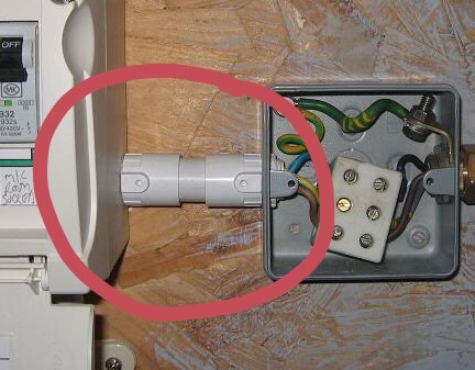

similar to this set up.
When fixing the front cover ensure the screws are NOT long enough to cut into the cables.
The "electrician" should have used the knock outs in the other walls of the box.
Connecting the banjo direct to the Earth in the terminal block would have been better than taking via two screwed terminals.
Even better to have stripped the SWA back so that the cores and inner sheath of the SWA could go straight through to neutral bar and MCB in the consumer unit

Thanks for that, the swa has already been fitted. Just not sure of the size. It's the run from the junction box to shed cu that's not there at the minute. That would only be about 300mm, I take it this run would need to match the swa in size?
This bit
