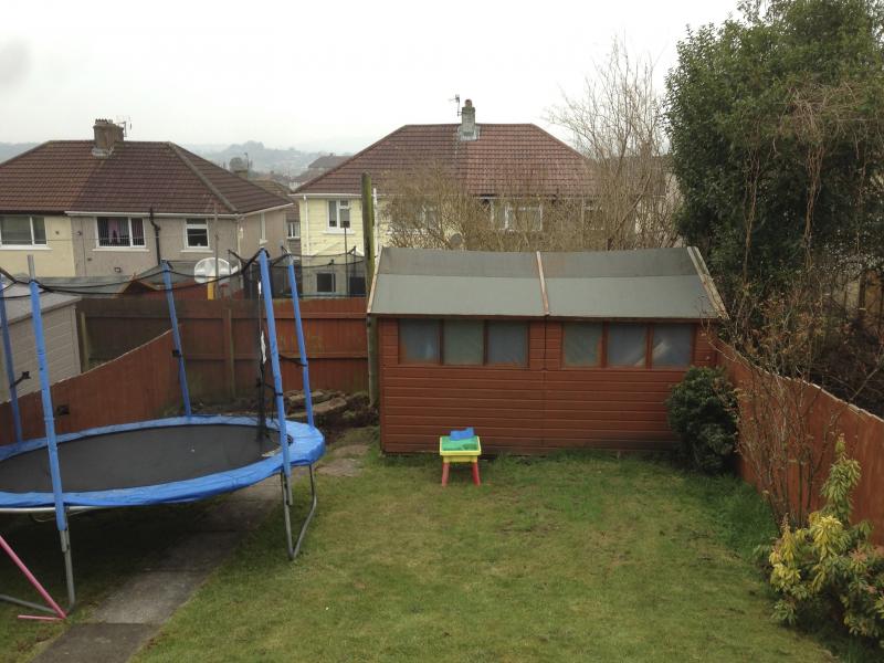

Ok, so I have a large shed (12'x8') at the bottom of my garden, currently just used for the usual...tools, bikes etc but it's pretty much all rotted at the back & sides so its going. Quick pic of the site:

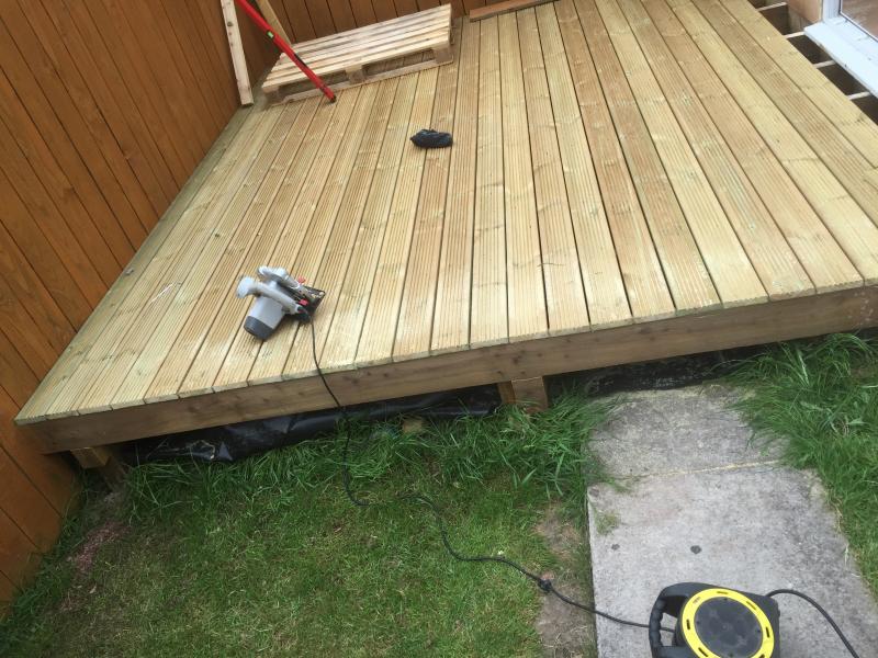

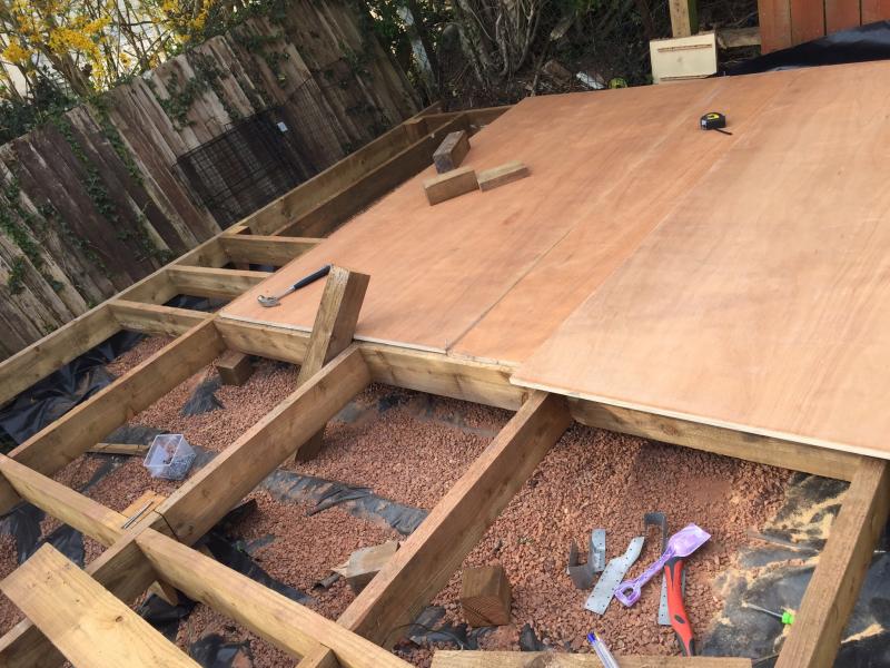

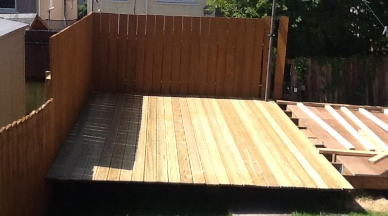

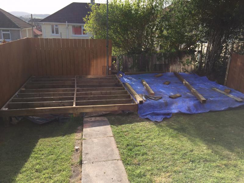

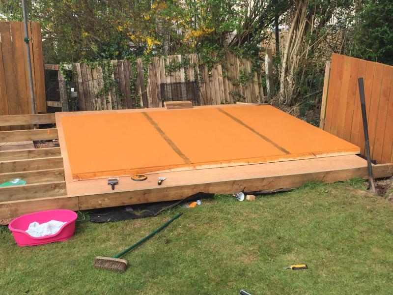

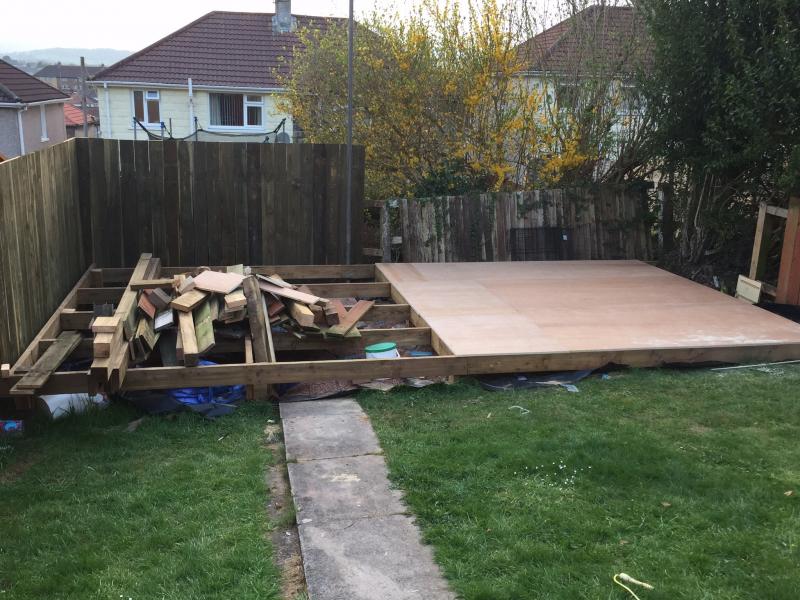

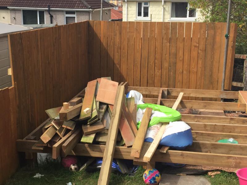

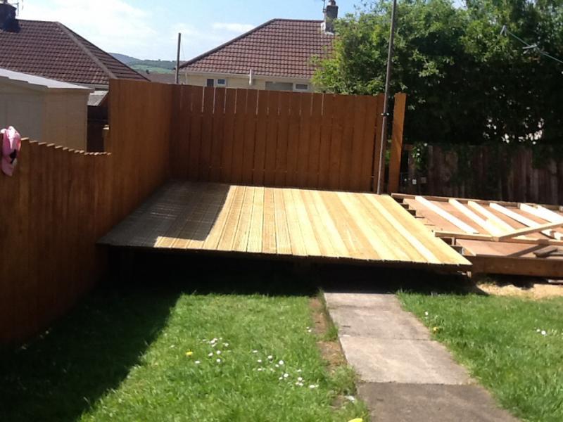

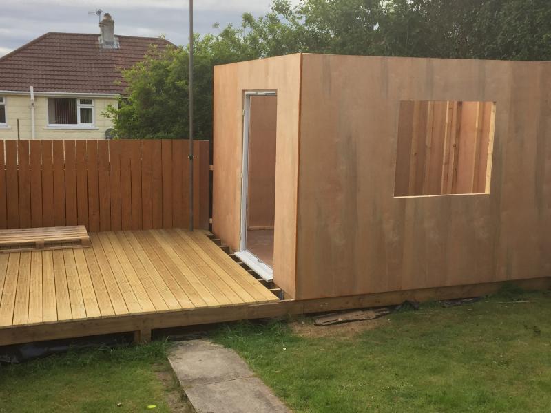

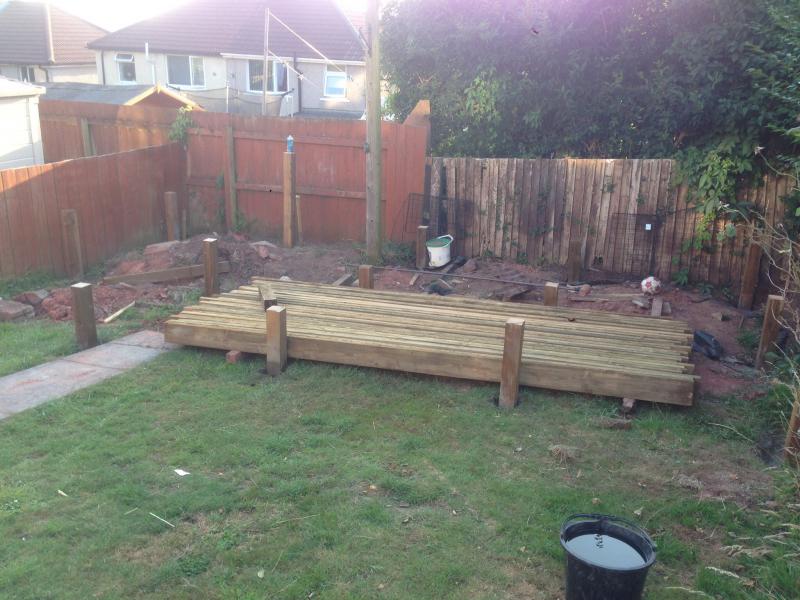

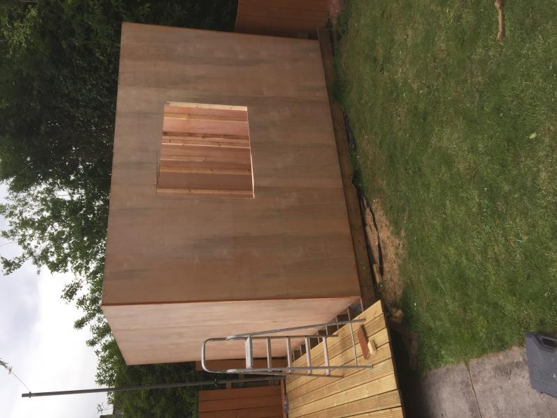

Well, the initial plans didn't really make it past the Mrs and with one thing or another getting in the way the shed took a backseat for a while. Had a bit of spare time recently so got to work and changed things slightly. Initial plans were to have a full width shed/mancave. Her indoors wasn't too happy with that so we compromised and have gone with half decking half shed. The sheds still 3.4m x 3.4m so still an ok size. Also changed mind and went with wood instead of block. Purely because I can work with wood a lot better and would be relying on others a lot more if it was in block.
My progress is here: //www.diynot.com/network/welshman9/albums/15464
Just thought I'd do an update really 😀 not too sure why some images are rotated on here, they're not on the original.
