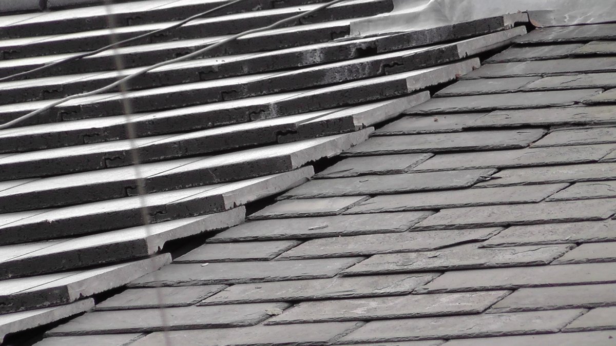

Should this be left like this

My neighbour has had the roof replaced. The builder has not sealed up the edges of the new roof where it joins mine. Is this normal ??? Or should it be sealed to prevent rain blowing in.
I dont know about normal but its wrong. There should be a Bonding Gutter of some kind between the two roof surfaces.
Plus, while the roofers were up there they worked or walked on your slate and chipped and delaminated some slates. Dont allow them on your side without working from a roof ladder.
I say this because there's going to be a bit more work in retro-fitting a Bonding Gutter.
Has your neighbour had their slate roof swapped for concrete tile?
Yes they have had that done... OK about roof ladders too. I will have a chat...

Heavy concrete too. Just look at the sag on it!!

top cut tile that comes from under the flashing has the bottom left corner missing. (the channel) note the hole.

Oh yes I see that now... Not my problem thankfully. Its rained VERY heavily the last few days and im still dry... so Hey Ho...
