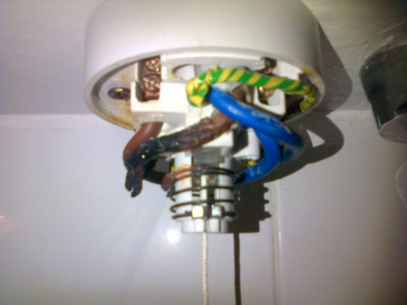

Attached are 2 pics of my shower isolation switch, located in the corner of the bathroom, about 2-3 metres from the shower. It was installed in Nov 2012 and has been working fine, but recently (last couple of weeks) the switch was working intermittently - you can see why...
Before I call out the electrician that connected the shower/switch/consumer unit, any suggestions what may have caused this?

Loose terminal which overheated, needs replacing. Also the burnt ends of the wires need to be cut back to clean bright copper before the new switch is fitted.
The green "stuff" between the brown and black wires suggests there may be moisture ingress as well.

Thanks both. Re the moisture ingress, is it possible to prevent this?
If that's what it is, and if it's due to steam/condensation, then probably not - beyond measures (extra fans etc.) to reduce the amount of steam around.
Also, is it advisable to ask a different electrician?
I wouldn't personally think so. Since the problem probably arose due to him not tightening the terminals enough (which has been known to happen to the best of us!), he might even be 'sympathetic'.
One thing no-one has mentioned - one obviously needs to make sure that the switch has a high enough rating for the current concerned (obviously 'too late' for the old one, but essential for the new one!).

Have back an electrician who wraps sticky tape rather than using sleeving? ... I'd get a different one, I can't believe he didn't have any G/Y sleeving in the van. He smells more like an odd-job man than an electrician.

If you look carefully, each cable has been passed through the incorrect cable entry on the base of the switch, so the wires have to 'cross over' to get to their correct terminals.
Now space is very limited in those pull switches (Crabtree/Marbo perhaps?).
Get another electrician to fit the new switch.
A reputable one.
The pictures suggest to me someone inexperienced has fitted it.
No electrician used to fitting such products which cross the wires over like that. You can see where the wires have been pinched against the cup that covers the switch.
The lack of earth sleeving says it all. If he did have some earth sleeving, perhaps it was too small.
The correct to install those switches is to connect the browns and blues up before screwing the switch base to the ceiling. Otherwise you can't always get the screwdriver in successfully if the wall is in the way.
