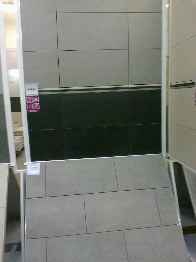

Hi L,
Perhaps that's why he is cheaper than the first!
As a compromise, can I use cheaper tanking liquid? Say Screwfix or wicks, as he will use water proof grout.
I haven't bought the tiles yet, but I think not the largest? as the top ones in the photo. I'm working out whether to go for the more expensive vitreous type.
His quote says he uses waterproof grout supplied by him?
C.
