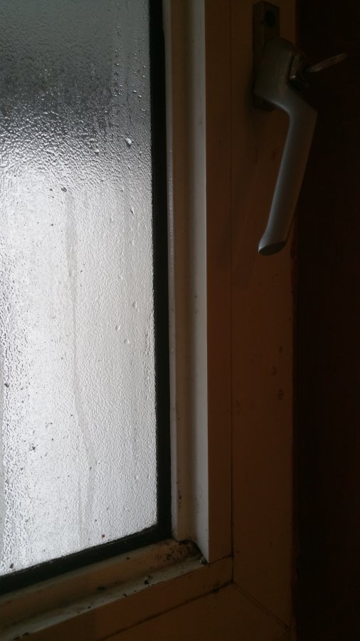

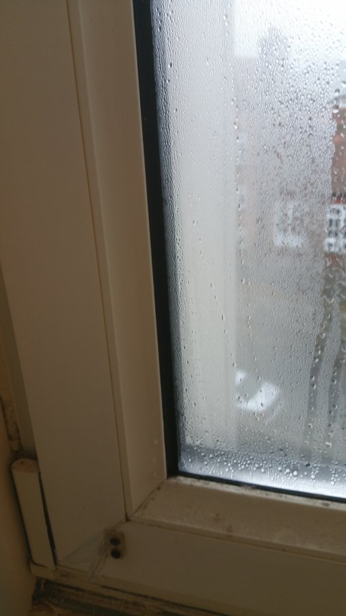

Hi everyone,
Working on a property (listed council block) which has single glazed upvc windows in some rooms and double glazed in others.
Identical windows just the beaiding is wider.
Could i get replacement beading for the single unit?
Thanks for the help

Beads are profile specific not universal so you'll need to know what make of profile the windows are made with, even then depending on age the profile or bead may be obsolete
Thanks. So it isn't as easy as I thought.
Looked at all around but no manufacturer's name.
The odds are pretty much 0% I'm afraid.
Noone has really even made single glazed PVC for at least 15 years I would guess, So even if you knew the make it would be obsolete
The plan would be to replace the glass to a double sealed unit. So i would need a reduced size beading. The one atm is 42x20mm where the single panel is and 25x25mm on the double glazes windows.
