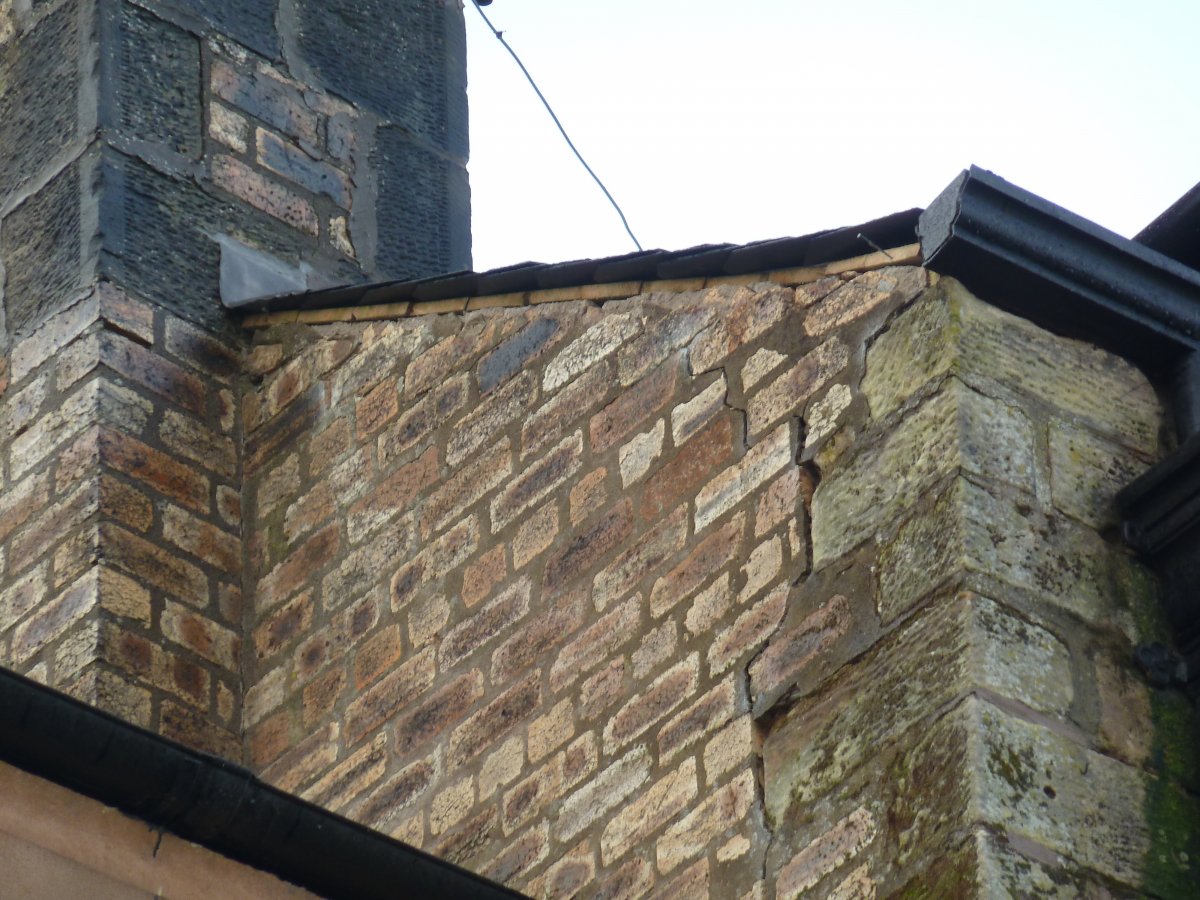

Hi there,
I've recently had some work done on my roof and I'm not completely happy with the slate verges as I think the should be finished off with an undercloak and mortar (see photo). Best ignore the large crack too as this was missed during the work...
Is this a suitable method of finishing the verges off? It face north west so will see a fair bit of the driven rain.
Cheers
WM
Its not finished. An undercloak and bed would be best in that situation.
I guess originally it may have been pointed up from the brick to the underside of the verge slates. As it stands it needs work. And tell them to take that friggin nail out by the gutter that they used for their strung line..
Are those bits of wood ready to be smudged up with mortar?
I'm surprised that their Labrador missed that crack. Training must by slipping at the RNIB. :rolleyes:
It was not uncommon to cut pieces of batten in between slate batten, as in the picture. This allows better fixing scope.
But in this case.. to be left exposed in an unfinished state.
Thanks for the responses folks. It is as I thought, a fairly poor job, or rather a half finished poor job.
I'm torn between accepting stuffing mortar in the space or asking for the slates to be lifted and rebedded. I know which I prefer and which he'll prefer...
Cheers

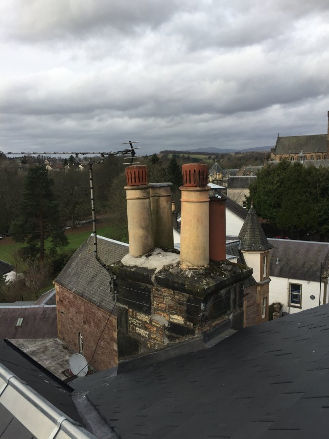

Do you have a Photo of the actual slate work?
The slate work looks good and having further discussions he's adamant that finishing it off like that is how it's done. They've done many roofs and finished them like that.
I'll try and get a picture.
