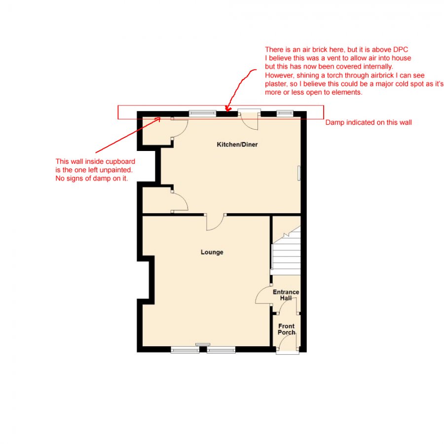

The chimney breast is in the same room. Basically there was a chimney in the kitchen as well as the living room. I have scribbled on a quick diagram to show you the position of these cupboards, and where the wall is in relation to them.
Can I specify that I want to appoint the surveyor? Currently Barratts are paying for the survey to be done. I have no idea how much this costs. I am of the opinion that it's not needed and that there is no damp problem, so I am loathed to spend money on it, however, there is this chance that Barratts could want money from me in the long run. I should point out I have heard from other Barratt customers that they had similar issues come up when they part exchanged, but nothing more came of it, so I might just be overly cautious.
The countrywide surveyor was sent out by barratt also. They get 2 valuations, and then take an average of the 2. Both did nothing more than stick a moisture meter on the wall.

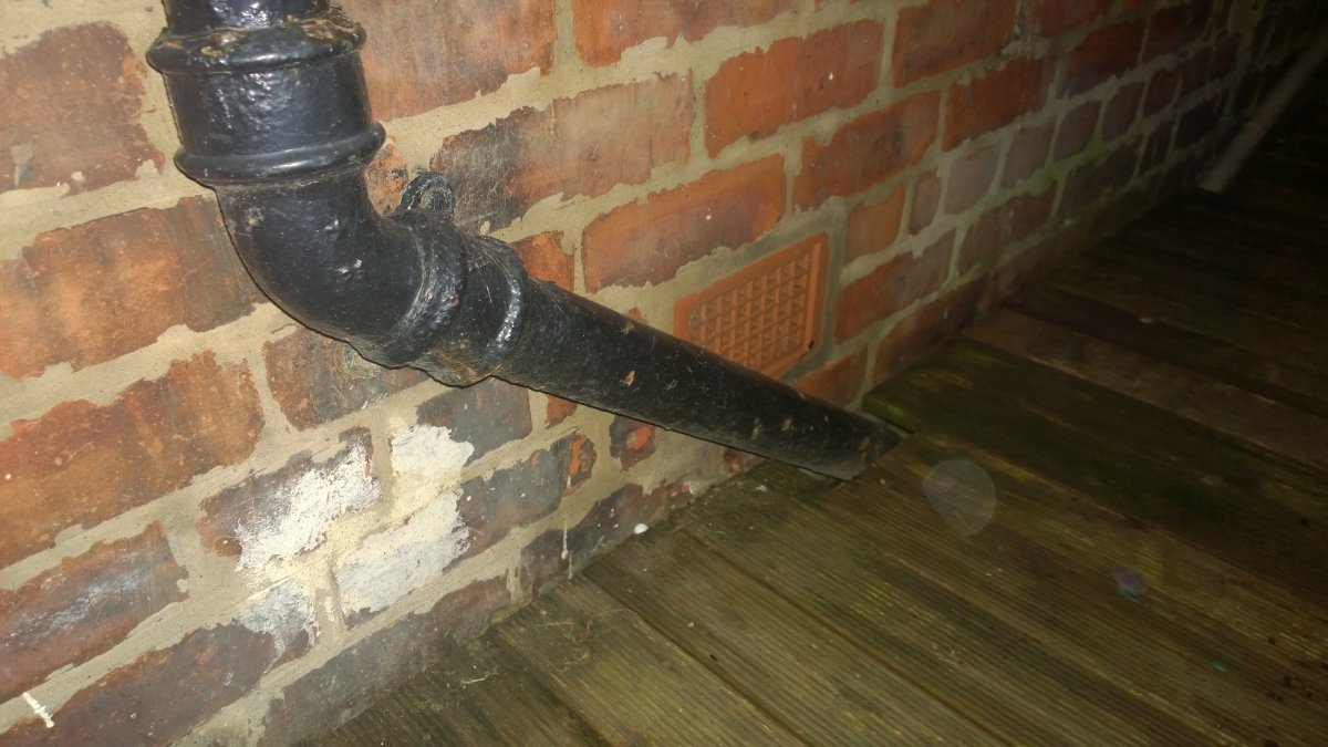

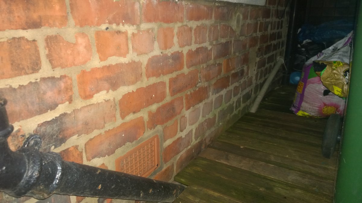

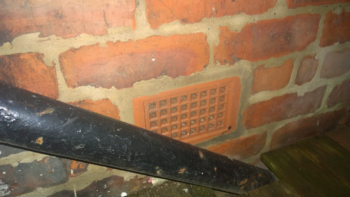

I have noted in the diagram that there is an airbrick in the wall, but it is above DPC. This appears to have been a vent, which I believe was required when people had back boilers or open fires? This has been blocked on the inside, but still open on the outside. But when I look into the airbrick I can see the back of the plaster. Nothing has been bricked up or blocked up. This is probably a major cold and damp spot?
I have looked for a damp proof course, but I can't see it. I think this is because when the pointing has been done any visible signs of it has been covered over. Also, I stupidly have decking to the rear which was to make the rear yard useful, but that means the decking is at floor level and the DPC is probably level with it, making it difficult to observe. (I know you're going to ******* me for having decking at floor level, or just having it at all).

It's the outside wall (cold) on the kitchen (steamy)
So it will get condensation.
Get on with ventilating, and stop draping wet washing in there.
Does the old pantry have any ventilation?

Yes, cold wall and kitchen is steamy, so I believe it to be condensation.
I have informed the wife to stop drying the washing on the radiator. I have a black eye for my efforts, but she has taken note.
There is no old pantry, do you mean the cupboards in the corners of the room? No, there is no ventilation in those. The one adjacent to the back wall contains the combi boiler and the washing machine. That cupboard does contain cobwebs and dust, and they are bone dry.

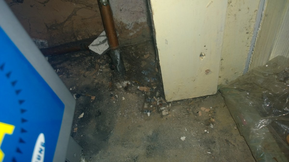

The cupboard in the c/breast recess that you mention is certainly a candidate for condensation, likewise any units against the outer wall.

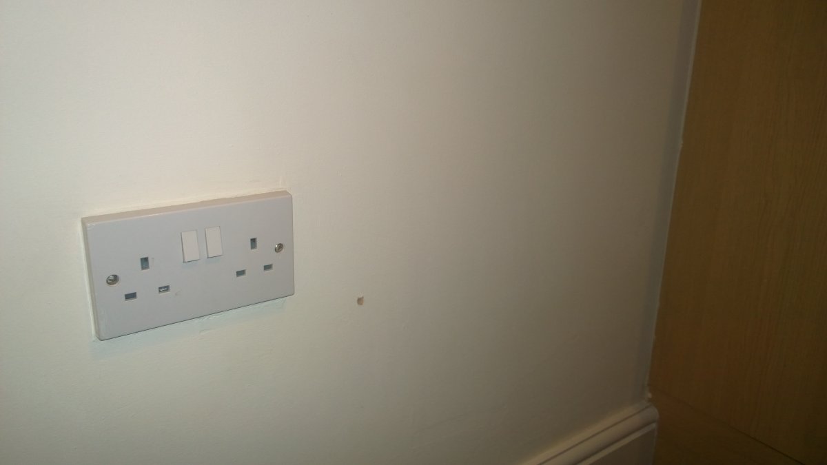

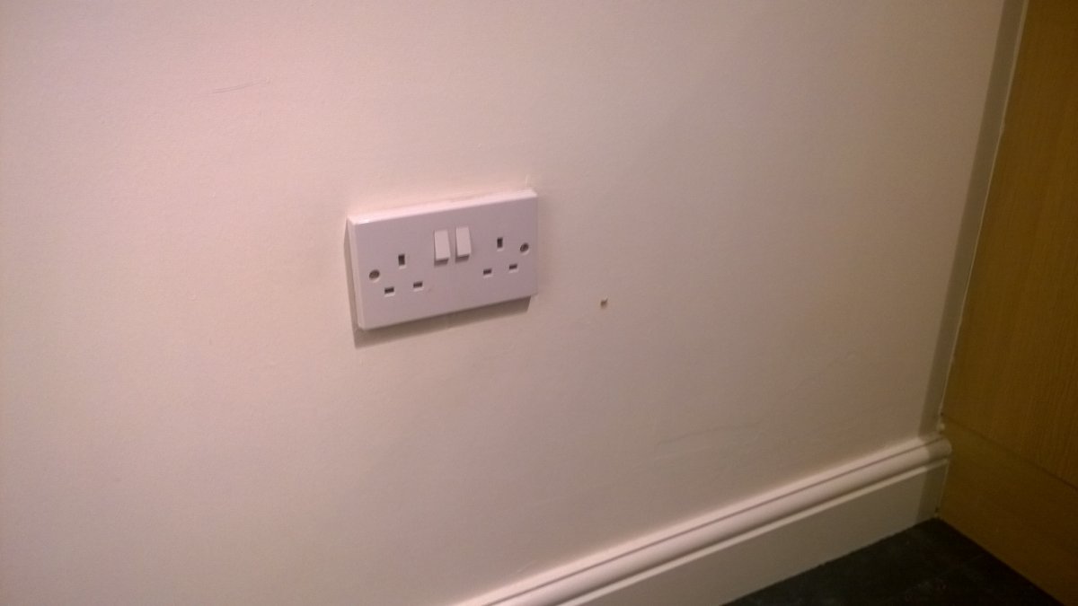

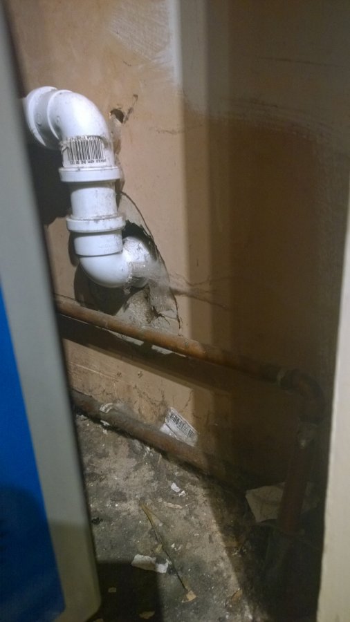

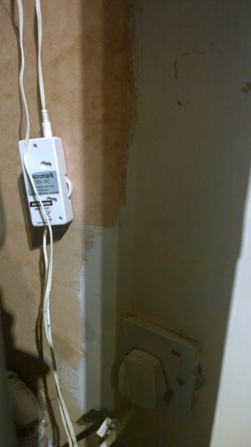

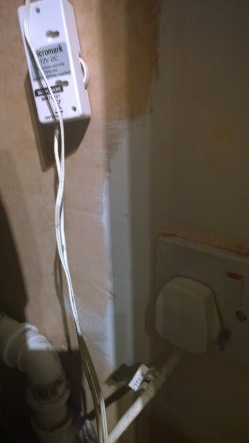

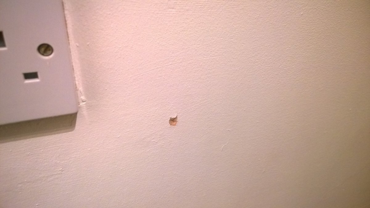

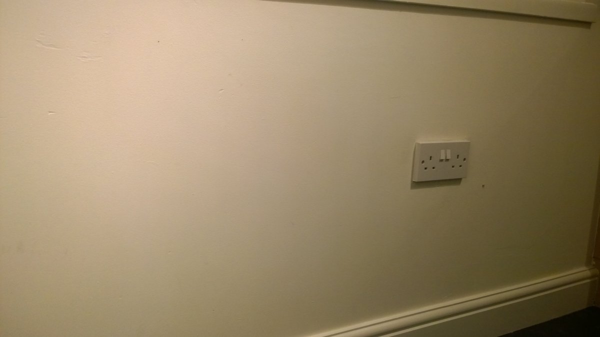

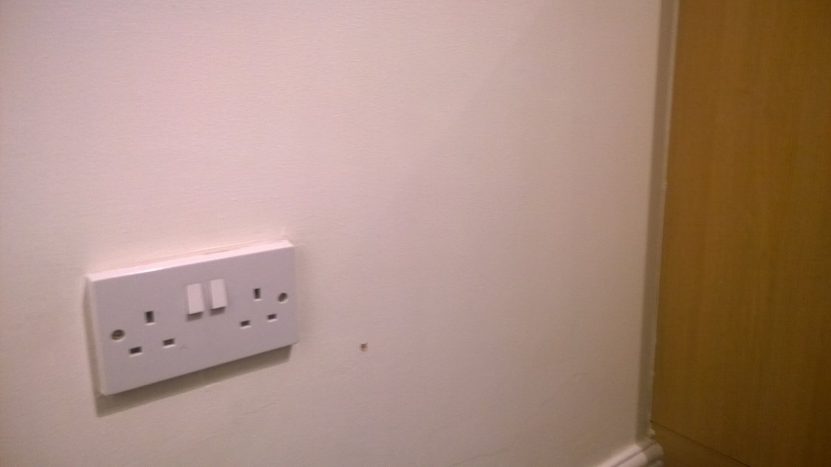

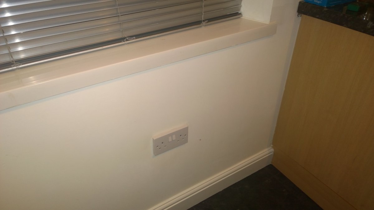

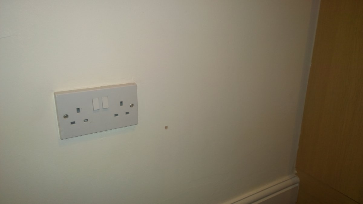

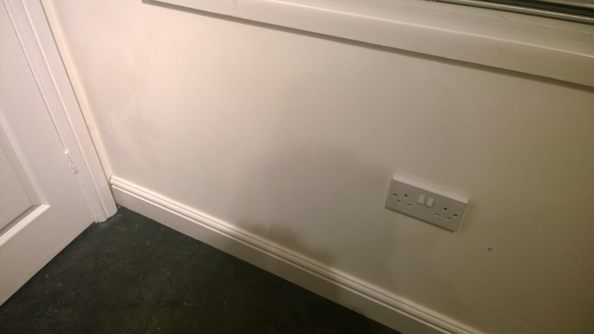

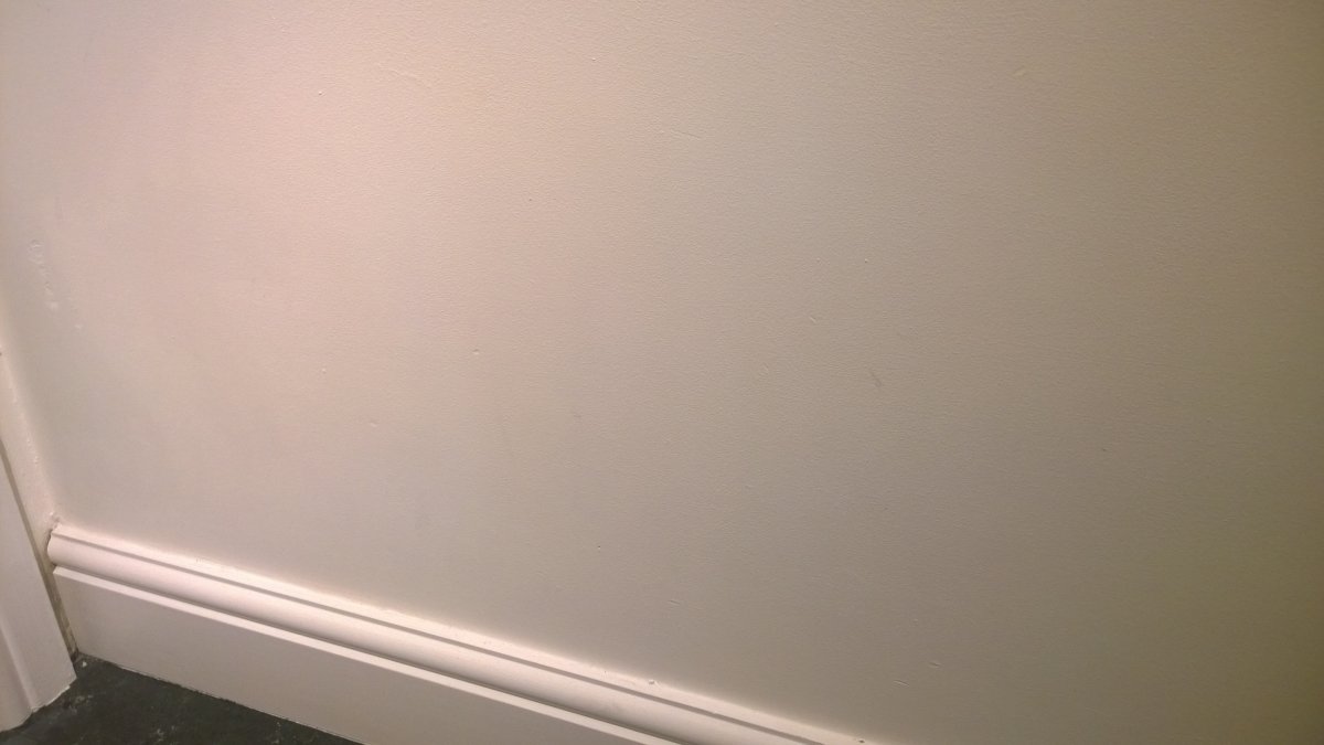

I have posted images here of the wall and the outside showing where the air brick is, and also inside the cupboard with the boiler and washer in.
You can see lots of dust and cobwebs in the cupboard, but they are dry. Also the door frame to the cupboard is free of moisture, mould, or any visible symptoms I would have thought would suggest damp.
I took a close up of the chip on the wall, just to show this was due to me dropping an allen key rather than the wall crumbling :)
As you can see the wall is immaculate. It was painted probably 5-6 years ago, and displays no tide mark, or black spots.

Indeed, your damp specialists have been on the go for years, and I'll reserve my judgement on them....
That looks like a canny wall to me! Minimise your condensation and invite Barratt back, emphasising the condition of the wall regarding paint and so on. It's their job to cast doubts.....
