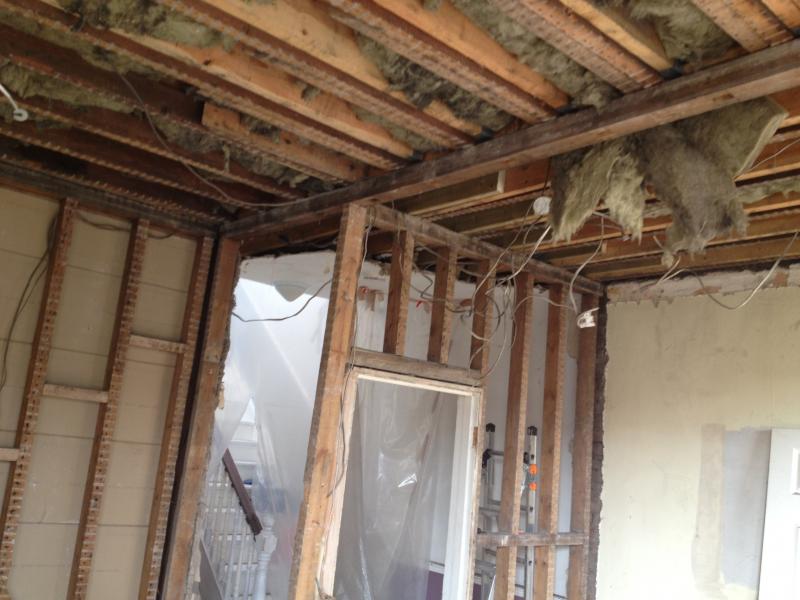

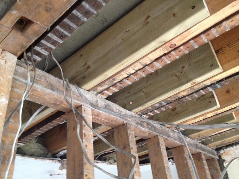

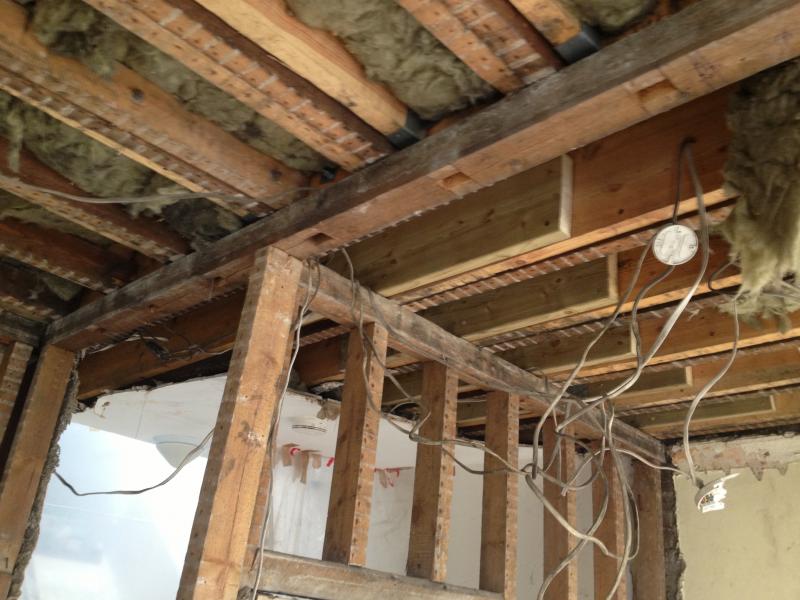

Hi there, i am in the process of removing 2 small walls from the corner of my little living room and i wanted to make sure that the roof and floor above does not collapse.. We have a standard edwardian house in london where a loft extension has been done above the living room, and new floor joists put in. The joists measure 220 by 47mm. I have taken some pictures of the "corner after we remobed the old lath, plasterboards, some insulation etc. the problem is that the new beams are cut above the small old beam for stud wall. Since they are cut i put in some splices also with 220@47mm timber. The question is how strong are such splices normally when we remove beam below that they currently lie on? The length of span is 4 metres on one side and 2 on the other. Thanks for input!
From what I'm reading, you're asking if you can take the wall out and turn what is currently a 4m and 2m span into a single 6m span?
For starters, even if it was a single, piece of 220x47, that wouldn't be enough for a floor on that span:
http://www.bsw.co.uk/uploads/files/bsw_timber_c16_span_leaflet_a4_4pp240810.pdf
The center deflection of a beam is a function of span^4. So even a short increase in length has a significant impact of how bendy your floor will be. adding 2m is not trivial and I would imagine steels will be needed.
The size of the timbers on that wall indicate it was load bearing for the roof and should have probably been upgraded when the loft was re-done.
If you have just joined two joists together with a splice, and take the wall away.... Best case, your floor will droop. Worst case, the splices will split and the entire floor will collapse. Possibly pulling the roof and outer walls as well.
Also, for structural purposes, nails have a higher shear strength than screws (I see turbo golds or similar in pics). However, joists should be bolted together (M10+) with dog collars between timbers and large washers.

It looks like the 220x47's are doubled up. What exactly are the splices joining?

The reason it looks like 2 or more joists is that the older looking one, darker, is only 11cm or so tall, vs 22cm for the newer, and used to hold up the old ceiling before a loft extension was put in.. I have screwed the old and new together to add some stiffness, i did not take the old ones out, but perhaps that does not make any difference. There are a few places where there are 2x new joists bolted together like you say, but that is not for the entire floor area.
I thought about using some metal beam before, but my wife wants the ceiling to be entirely flat, with no supporting beam cut/out below..any suggestions for how to do that^

Hey guys, no fighting, you are all great that take time to look at this! Really appreciated for this one / I think I was close to having a little disaster here.. I called over a struct.engineer that said an steel beam is definitely needed if I want to remove that wall under my little wood splices. One problem arose though since he said I need 15cm height of the H type RSJ, and I really would want to avoid that to minimize ceiling height loss. Do you think I could use any other type of beam, e.g. a solid one, or rectangular one? Thanks
:eek: Hey, nobody's fighting! :LOL: :LOL:
Fubar was right, 6m is a long span and you won't do that with a timber beam.
He also mentioned deflection, and that will be the critical factor here.
The beam your SE has recommended seems to be a 152 x 152 column ('H') section.
It is dubtful that you will get any beam shallower than that and still keep deflection within limits.
I suspect you will have to live with a downstand beam.
