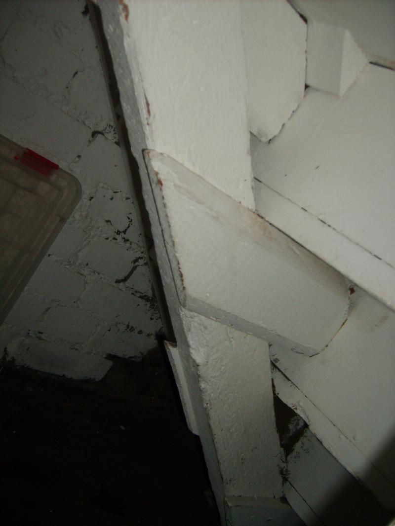

I'm planning to put in one or two side slide-out storage drawers in the lower part of my stairs, but there is a pretty chunky rail running up underneath the middle of the stair which I take to be a support. The stairs are edwardian in a terraced house, and they appear to have supports either side of the stair as well as this one in the middle. The problem so far as the storage is concerned is that this rail really sticks down into the space which would limit the depth of the drawers I want to put in. I know that my neighbour has put in a drawer of the design I would like to do and there is now no evidence of a central rail under his stairs, but since he moved some time ago I can't ask him how he did it. It does look as if he took the rail out, though.
Anyone have any expertise on staircase structure which might help?

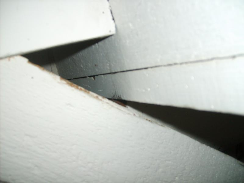

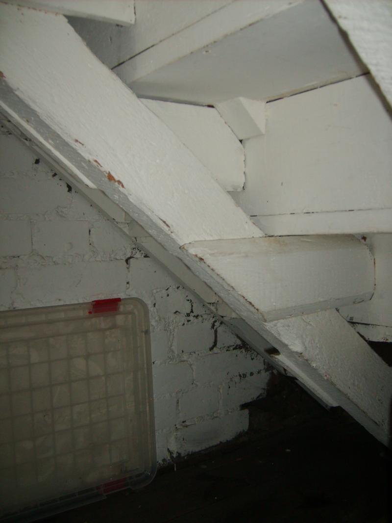

As you can see it's a rail right in the middle of the underneath of the stairs, but it looks as if many of the stairs don't actually even rest on it, and I'm wondering if it was used as some sort of temporary guide when they were building the stairway. Unfortunately, further up the stairs is panelled in so I can't see if the situation is the same there. I'm hoping one of you might recognise this sort of consturction and know whether this is something tht is safe to remove or not.

do not remove it a timber that size is structural
the stairs are unusual the riser normaly screws into the back off the tread as thats strongest
suspect its badly made and the support is an attempt to stop it collapsing
It is called a carriage piece, not normally used on domestic stairs. Your one has been hand made and fitted after stairs have been pitched.
Without seeing more photo’s, could not tell you why it has been fixed. Possibly undersized strings, and stairs bouncy or squeaky treads.
Can you take it out? Put it this way, it has been put in for a reason by somebody who understands stairs and after the stairs have been pitched.
With no disrespect the stairs do not look like they have been made up in in a joinery shop.You could cut out the bottom 750mm or so and put a leg in, but I would suggest you leave it in.

Hi if you could send the images from behind showing how the steps and risers are fixed into the left wall side and right hand side, also were the bottom and top of this support goes to this will answer all the questions, we have see lots like this and may be a case of adding a triangle support under each step both sides www.shawstairs.com
