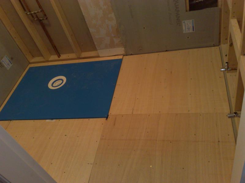

Ok, so today I started at 6.30am as I had a day off. I've just finished so bringing the project news up to date.
As you will see from the pictures below, i've managed to get the towel rail heating pipework sorted and in place, all of the drains in place, the floor noggin'd (not a real word), the chipboard floor down and the shower former in place. I then also managed to get the wiring started for the underfloor heating and also got the plywood down for strengthening the floor. I feel I made good progress today even though it seems like slow going. I'm off for a lager!
:D
As you can see, the gods of level flooring were smiling on me today! :D

Hole in the wall is for fitting the switch and thermostat for the underfloor heating.
I really should tidy up but I can't be bothered. 12 hours non stop is enough.
Unfortunately, I didn't get the plaster board finished off as a certain well known building supplier delivered 9.5mm instead of 12.5mm plaster board. :mad:
Might get some bits and pieces done tomorrow but there'll be a delay in the proceedings until next week.
Why do I get all these jobs? So much for days off.
