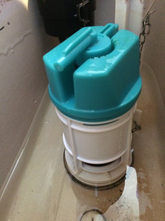

Hi,
we've got a sticking siphon that I can't identify.
I've taken a picture if anyone could help?
Is there anything I can do to fix it without replacing. It has arrows on the top saying lock and unlock but I'm loathed to twist it and find out what happens until I know I won't wrench the thing off in my hand and make it worse.
The arrows allow you to twist the whole flush valve off of the coupling at the bottom. 1/4 twist anticlockwise usually unlocks it, it unlocks with a click.

I know know that this isn't a siphon but a drop valve. :)
I've twisted the green top and the valve comes out of the "housing" and moves up and down freely. It's only when I put it back it fails to drop back and the toilet continues to drain into the bowl until we give the valve a push. I have run my fingers round the inside of the housing to see if it felt like anything was there to make it stick but it feels nice and smooth.
I was going to ask about replacing the whole thing but decided to give the inside of the housing a rub down with wet and dry and this seems to have fixed.

When you're talking about a tenner to replace something that if you fix may cause problems in the future, I'd go for a replace :)
Looks like you have plastic screw heads in there too so getting the cistern off to swap out the flush outlet shouldn't be an issue either. Just get the doughnut back onto it's 'grooves' when putting the cistern back on or it'll leak. When you get it off you'll see what I mean.
If the fill valve is plastic just be careful the nut is on square before tightening when refitting the cold inlet.
Thanks Madrab. Replacement sounds like the best option. I'm assuming I can convert my toilet from a drop valve to a dual flush siphon?
Chuck it out and buy a Fluidmaster PRO550UK or PRO750UK instead (550 is a push button, 750 is a handle)

Sometimes the base part of the valve goes slightly out of shape (oval) so although the top part feels ok when removed, it doesn't fit when replaced. The only option is to replace.
