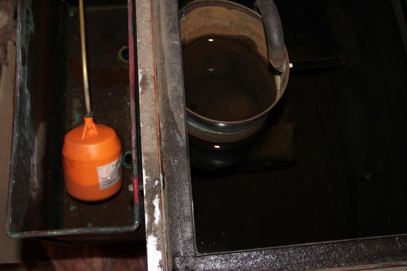

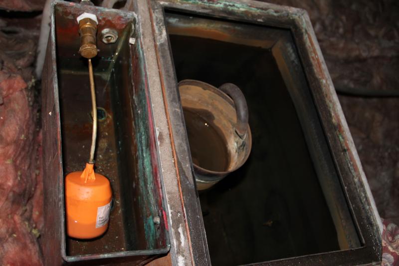

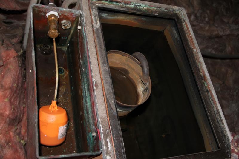

I'm afraid I cannot describe the system that well however I have a Baxi Bermuda LWH0345 gas back bolier.
There are 2 tanks side by side in the loft. The whole system is 20/30 years old.
The smaller (header tank?) has had the ball cock and valve replaced and it fills approx to 2 inches only but still overflows when the hot water is switched on. This has worked OK in the past and no recent work done on the system.
Any Thoughts/help would be appreciated Photographs uploaded

You appear to have an ancestor of this http://www.gotogasdocs.co.uk/download/?i=Elson_Rectangular Combination Tanks_Amethyst.pdf .
They don't make them anymore, and what is meant by a pinholed coil is that water from the central heating system is making it's way into the hot water. Are you sure you don't have another tank, the F&E tank, whose water is higher than the hot water tank and thus creating the overflow? Even if it isn't it might just being pumped in via the pinhole.

To clarify I have no other tanks other than the 2 in the photographs I have uploaded. Its a Baxi Bermuda back bolier with HW and CH. Pump under floorboards for CH.
The biggest tank with hot water does not have a coil as in the PDF but what looks like a exhaust silencer in the bottom. I suspect this is the coil then and maybe has a pinhole leak. It overflows when no pump is running.
So it sounds like I have a dodgy coil that needs replaced or even a new tank. I am still confused how the CH system works as defo no other tank!

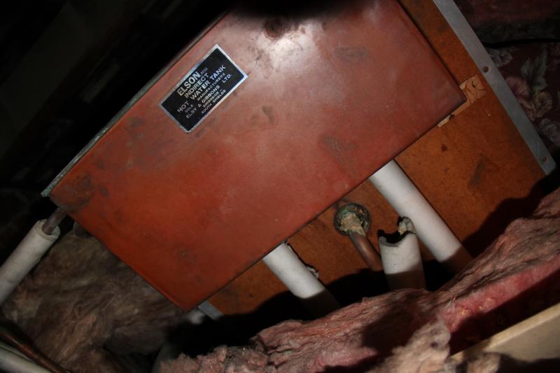

To be honest on a cistern that old and confusing it might be worth just calling up the makers and asking to speak to the Tech Support. They usually hold the oldest technicians there until retirement!
Describe everything that's on the plate.
Looking again at the photos it appears the round drum in the middle could be the F&E tank as the water looks more a murky brown, but how it keeps itself topped up is a mystery. How does the level in this drum relate to the level in the tanks?
If the level in the drum doesn't go down and isn't related to the big tank and ball cock tank level then it might be a manual fill type in which case the water height rise will be coming from somewhere other than the coil.

Probably not the tap then. Also I just realised if the F&E 'drum' tank does go down when it pumps water into the hot tank, it will bleed back through the hole in the coil and equalise the levels afterwards.
If the filler tank goes up and the drum level comes down during HW heating that will confirm it.
I find it strange though to see an F&E (if indeed that's what the drum is) plonked in the middle of a hot water storage tank. Time to call the maker.
