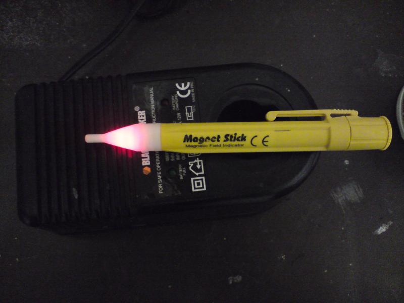

You can use one of these to check for a magnetic field - didn't have a solenoid to hand but picks up the transformer in the charger:
Available from here
(All it consists of is a reed switch, resistor, LED and a battery - if you are feeling inventive you can make your own)
The one I have does NOT detect voltage. It detects magnetism and has Magnet Stick written on the side of it. Please don't mistake it for a non contact voltage pen - these are two completely different detectors.
The one ericmark links to above does both but costs more :LOL:
