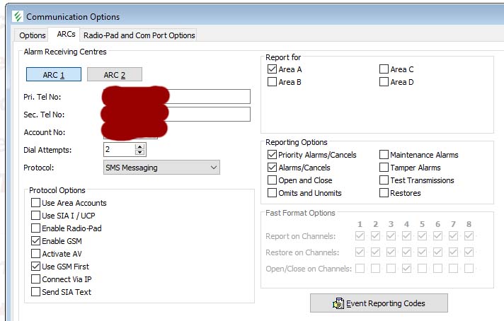

The other issue is that when the alarms have gone off the GSM has not sent an SMS to my phone as it should. Each time the bell sounded I have cancelled it within a few seconds, but I would have expected the SMS to be sent immediately. What is happening here? As a test I set the reporting options to report Open and Close and these reported properly every time, so why not on alarms?

2. The absence of an SMS report for alarm conditions. In the installation manual I came across the Area option "Full Arm Comms". It wasn't checked in the settings, but it is now and the SMS is sent as it should.

To be honest, I'm not sure that the SMS on alarm ever did work. It's mainly been used to text in and check the status when I've been away.
