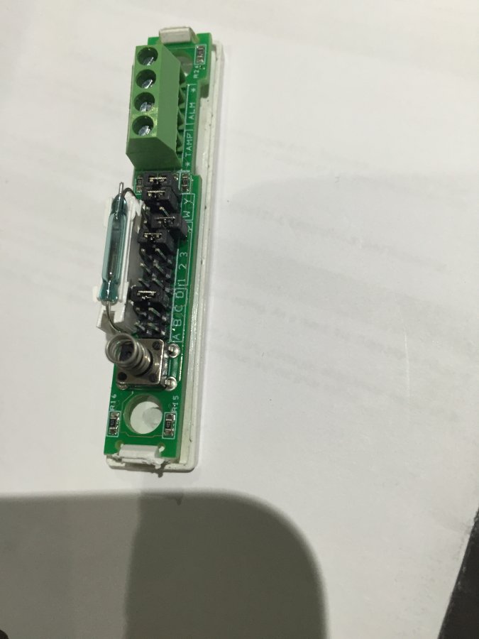

Hi
I am trying to wire up a Texecom Premier Elite 24 Metal Panel.
I am using:
5 x Bosch Bluline pet friendly PIR's
2 x Knight Fire & Security XEND24 Grade 3 Class II Door Contacts
2 x Texecom Premier Elite LCDLP Prox Keypads (one for house and one for garage so alarm can be deactivated at either location)
1 x Texecom Odyssey X-BE External Bell
2 x Kinetic 16 ohm Internal Sounder
Com IP Module (comfortable with this)
1 x 8XP Expander Module (fitted for expansion)
I have connected the External Bell & Panels as that is obvious as to where they go however, I do not know where I should connect:
The Bosch PIR's - Connectors - + NC NC T T
Door Contacts - Connectors as above
Internal Sounders
So desperate to get it wired up properly as this is my first Alarm as you have probably guessed!!
Any help much appreciated

Bosch pir , twist one leg of the 2.2 and 4.7 resistor together , put in NC in detector put the other leg of the 4.7 in NC with blue wire, put the 2.2 leg in one terminal marked T and the yellow wire in the remaining T terminal .
Contact
Select 4.7 for alarm
Select 2.2 for tamper from the jumper settings
Wire as indicated for eol
So at panel end your powered devices will have red and black for power + blue/ yellow for eol ( wire in zone 1, 2 , 3 ect ) your contacts will just have blue /yellow
Contact
Select 4.7 for alarm :?:
Select 2.2 for tamper from the jumper settings :?:
Wire as indicated for eol - I have the jumpers across C Is connected, W-X & Y-Z are connected. Not sure on the number one. Currently 3 is connected and 4 is not.:?:
Panel end your powered devices will have red and black for power + blue/ yellow for eol ( wire in zone 1, 2 , 3 ect ) your contacts will just have blue /yellow :?:
