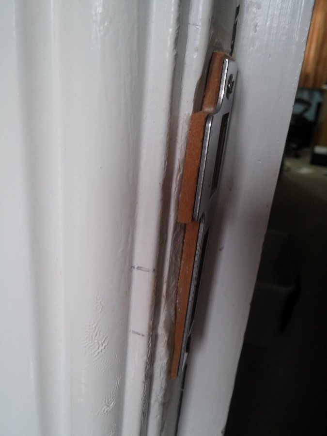

Hello,
When I moved into the house there was a problem with the bathroom door shutting. It would shut just not stay shut as the only thing which would keep it should was the bolt from the lock. To keep it shut without the use of the lock now I have put another plate on the frame which has been pushed out by a small piece of wood. This now holds the door in place but looks ridiculous.
Does anyone have any ideas on how to resolve this issue?

You may be able to pack the hinges out James, but I'm sure we would like to see a picture of this one.
Presumably the door isn't wide enough now for the catch to hold?

I have attached a picture of the issue in question. Please let me know if you need anything else.

I see, you have packed out the keep to allow the catch to hold.
The hinges will be set into rebates......how about filling those rebates with 3mm ply, carefully fitted, and then passing the hinge screws right through?
It'll hold, all right.

I presume you mean taking the door off and putting the 3mm ply behind the hinges to bring the door forward and then screwing the hinges through the ply and back into the wall? Remove the packing and put everything in its normal place?
Is that what you mean?

No need to remove the door, you can simply loosen the screws a little , open door and it will sag forward, pack space behind loose hinge with a sliver or card and tighten hinge.Make sure packing goes behind the hinge pin section.
