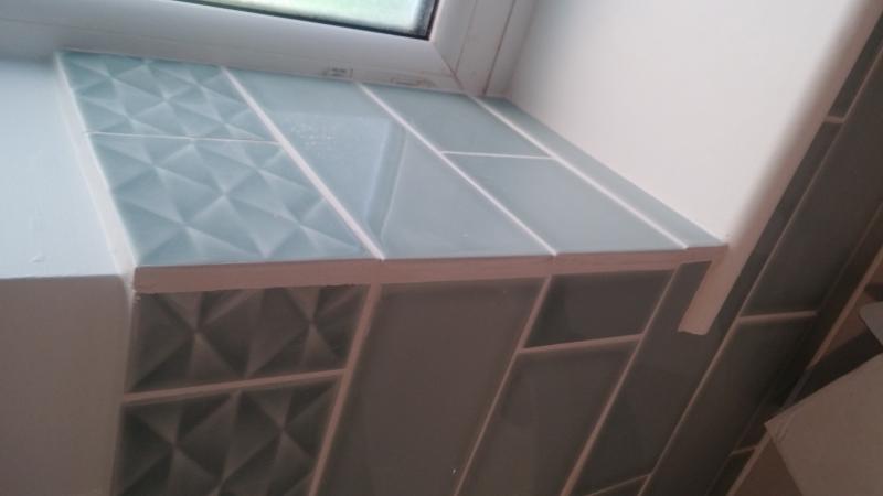

My tiler is telling me that he doesn't use tile trim in bathrooms.
All of my parents bathrooms and shower rooms have tile trim, so I am wondering what is best?
Is there is a good structural reason for fitting trim? For example stopping moisture getting into the tile etc. Or will some grout be okay?
Once upon a time tiles often had one finished edge or you could buy RE tiles where one edge was rounded.
Most tiles now are just plain and without trim you see a big expanse of unfinished tile that looks naff!
In some cases where you are painting up to a tile edge by painting the grout it can look quite neat but in most cases, like corners, trim would be my choice certainly.
That's not good. If it was stone then an exposed polished edge looks good and you can mitre tiles to avoid a trim. But having tile edge exposed as it is in the picture isn't right. Functionally it won't make a difference but visually it looks very poor & I wouldn't pay anyone who did this.
I will have a word with him on Monday. He suggested we use carpet trim last time instead of tile trim. He says he has it in his bathroom. I don't belive him. I think he suggested carpet trim because it sits on the surface and it is less work for him to fit.. :eek:
I haven't paid him for anything yet, so I will ask tell him as nicely as i can that I want him to fit the trim. The rest of the bathroom is nice so I don't know why he bodged the windows.
Carpet trim! That's a new one.
He'll need to take the tiles off around the reveal to get the trim in and make sure he redoes the cut around the window ledge so that the grout line gap lines up.
