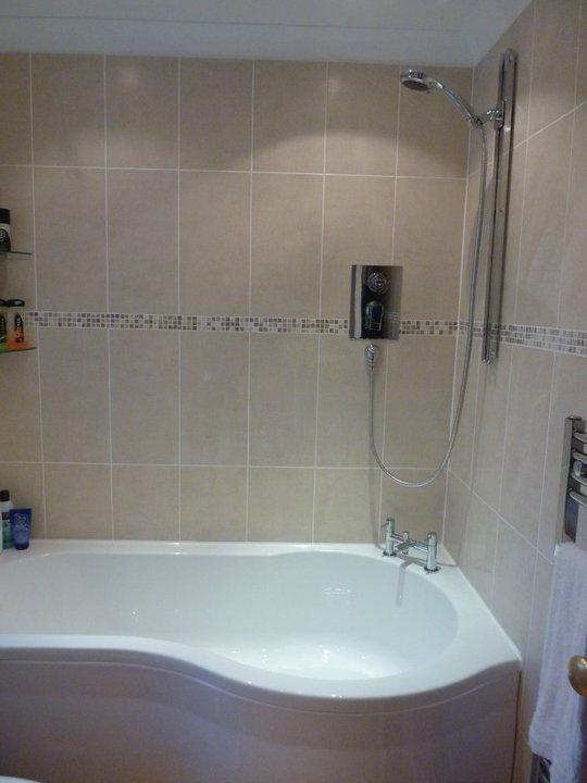

If you search for my past threads, you'll find a thread discussing this exact question. I dab/dot'd around the entire edge of the board, then a dab/dot every 3/4 inches or so to cover the entire surface.

Aquaboard has a built in moistureblock, it is also a proper tileboard and so is designed to support a fair amount of weight, for that reason I opted to use it throughout all walls of the bathroom that I was refitting. At least I know that in the event of removing tiles or fitting fixtures, the backing is nice and strong.

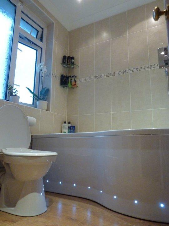

Disclaimer, I am not a professional but I'm a competent DIYer and have just completed a successful bathroom tiling, plumbing and electrical refit successfully - a professional on here even commented that the finish was better than most he had seen professionally :D Hope this all helps!
