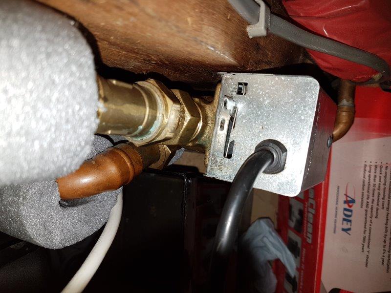

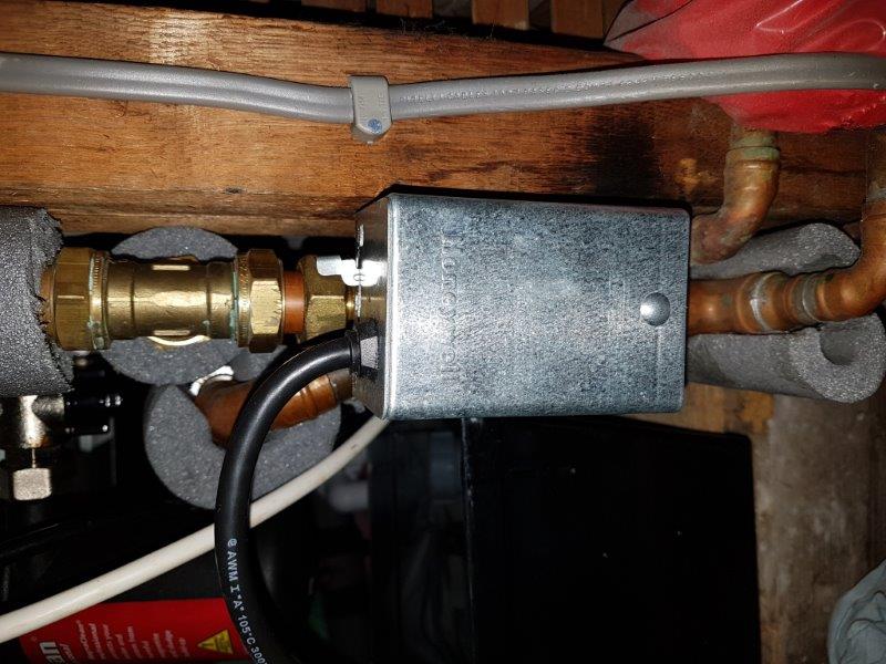

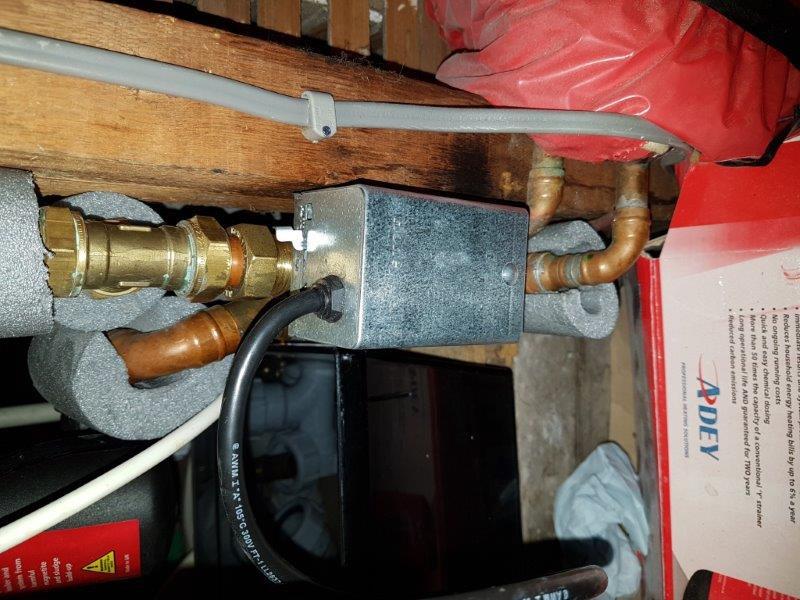

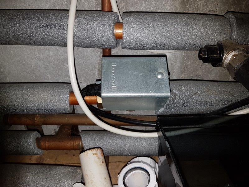

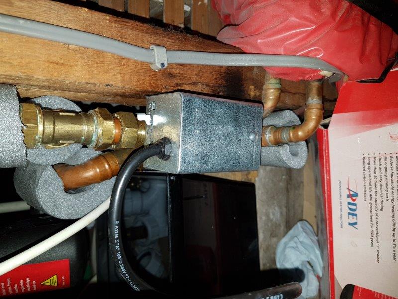

Absolutely fantastic reply Stem and makes it all more understandable. Thank you very much as I greatly appreciate the explanation. I had an issue at the weekend whereby the boiler wouldn't switch off. Though the thermostat wasn't calling for heat and the timer was actually off the radiators were roasting. I couldn't understand it. I believe it was a stuck MZCV which appears to have corrected itself. is this possible?
If so the next job would be to determine which MZCV actually services the CH as opposed to the HW.
Do you need to drain the whole system to change one of these?
once again Stem I can't thank you enough.. Thanks again..
your CH motorised valve is sticking intermittently, post a pic of the motorised valves, some you can change the actuator head without having to drain down but not all of them.
is it possible that this was the problem. Cheers Ian I'll do that when I get home... These valves are at the side of the boiler which is in the loft, no rads above this height, though 2 up the stairs. Hoping if it comes to it maybe I'd get away with shutting the header tank off, closing the rads off at both ends and only dropping sufficient water to do the change over. Thanks again...

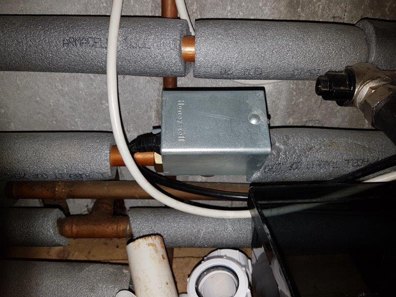

as requested please find pictures of the MZCV

The good news is they both have removable heads and can be replaced without draining but a good chance it is just the synchron motor in the CH valve that needs changing
If that's the case it is unlikely to be the motor, but more likely to be the microswitch or mechanism sticking. The valve wouldn't open at all if the motor had failed. So, the spring would keep it in the closed position and it wouldn't mate with the microswitch at all meaning the boiler wouldn't switch on.
If you read the complete post @stem he says the thermostat was not calling for heat and all the radiators were roasting, if it was a microswitch sticking the boiler the boiler would keep false firing but wouldnt heat the radiators, I have seen Synchron motors sticking in the open position before
OK agreed. I had forgotten the bit about the rads being hot, and focused on just the boiler staying on. The valve indeed must be open for the rads to get hot. so I stand corrected. My apologies and thank you for pointing it out.
Personally I've never known a motor to stick, I've only ever found the mechanism to jam & when I've taken the motor out it has always spun freely. Although it must be possible if you have come across it and you will probably have had more experience than me. Perhaps the OP will let us know when he's fixed it.

A lot more common for just the end switch to stick, but have seen the whole valve staying open, sometimes it is the mechanism sometimes its the synchron,I find the Honeywell ones that the OP has are usually the most reliable.

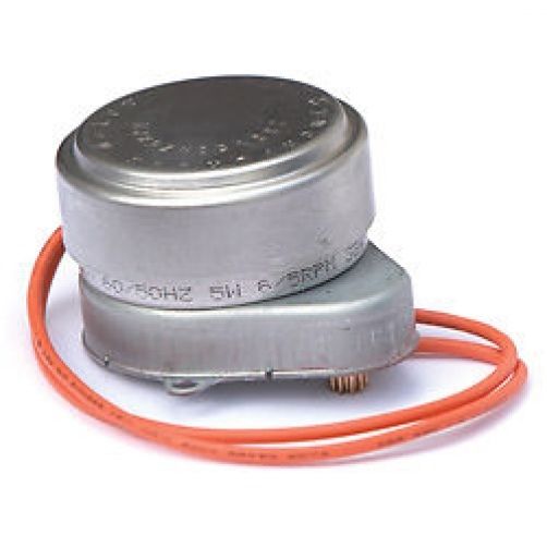

Thanks Ian/Stem what exactly does the "synchron motor in the CH valve that needs changing" mean to a layman? funny enough I've not had the problem since, personally I think it was one of the MZCV that had stuck. Also when you say the head can be replaced without draining is this a simple process?
The motorised valve is geared device, which is wound open by a synchron motor. Once the valve is open the motor stalls at the end of its drive but remains powered and so holds the valve open. When power is removed a strong spring pulls the valve back to its closed position. [at this point you can hear a whirring noise as the motor is spun quickly in reverse by the spring] The motors that I have replaced have failed electrically and do not operate so the valve remains permanently closed.
To change it you will need to remove the cover from the powerhead and there are two small screws that hold it in place. Once they are removed the motor is lifted out of position and replaced with the new one. The wires can be connected either way around. It's a cheaper solution than a new powerhead, but make sure it is just the motor that is faulty, otherwise you may still end up replacing the whole head. Bear in mind too that if the valve is elderly, then a new powerhead will probably be a better solution in the long term.
