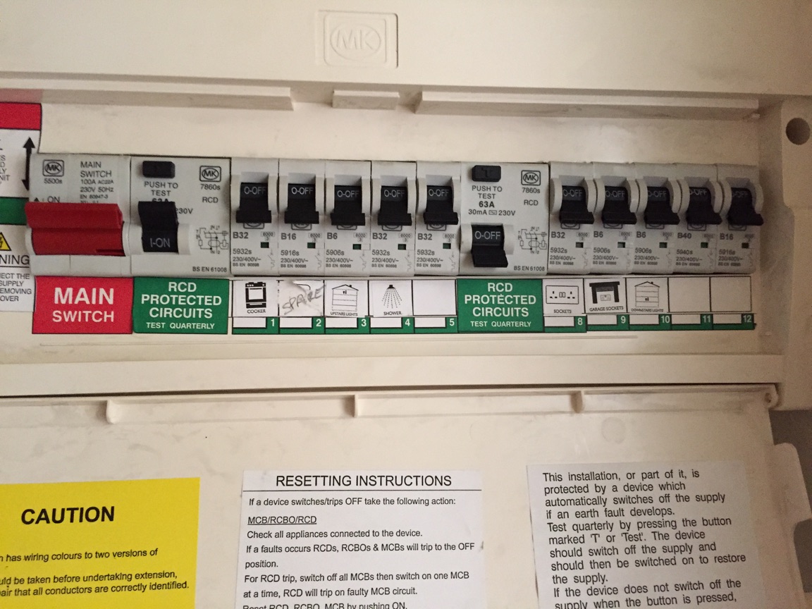

Just for reference this is the unit

It's very much a long-shot, but the one other thing you could try would be (with all MCBs off) to switch off the other RCD, and see if you could then reset the tripped one.
I presume you are just 'trying everything'.
There's no way that current on the 'other side' could cause the tripping without also tripping that RCD, is there?
Again pretty sure I have tested these scenarios but I will double check. ... I spent an hour there yesterday going through pretty much every combination, including I belive all of the above. ... I went as far as to swap the two main RCD over in the consumer unit and the problem stayed in the same location, I also removed the MCB's on the faulty side one at a time to see if that changed it and it didnt. ... I'll print of this thread and run through the scenarios you mention.
Fair enough - this is getting to the 'very mysterious' stage! You might as well initially bypass all the other things mentioned and, as EFLI suggested, turn off the Main Switch and see if you can reset the RCD. If you can't reset it, then there's no point in your trying anything else, and I think that would be the stage that you should 'give up' and hope that your electrician is good at diagnosing 'very mysterious' faults!
