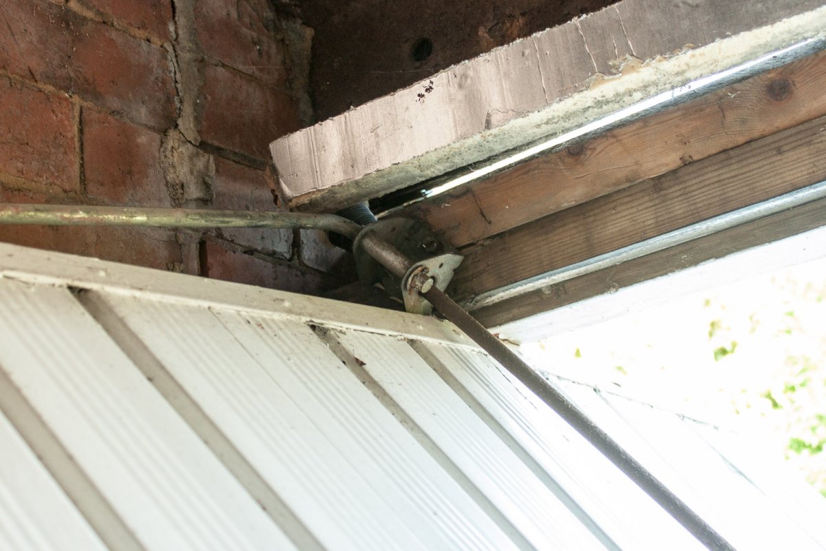

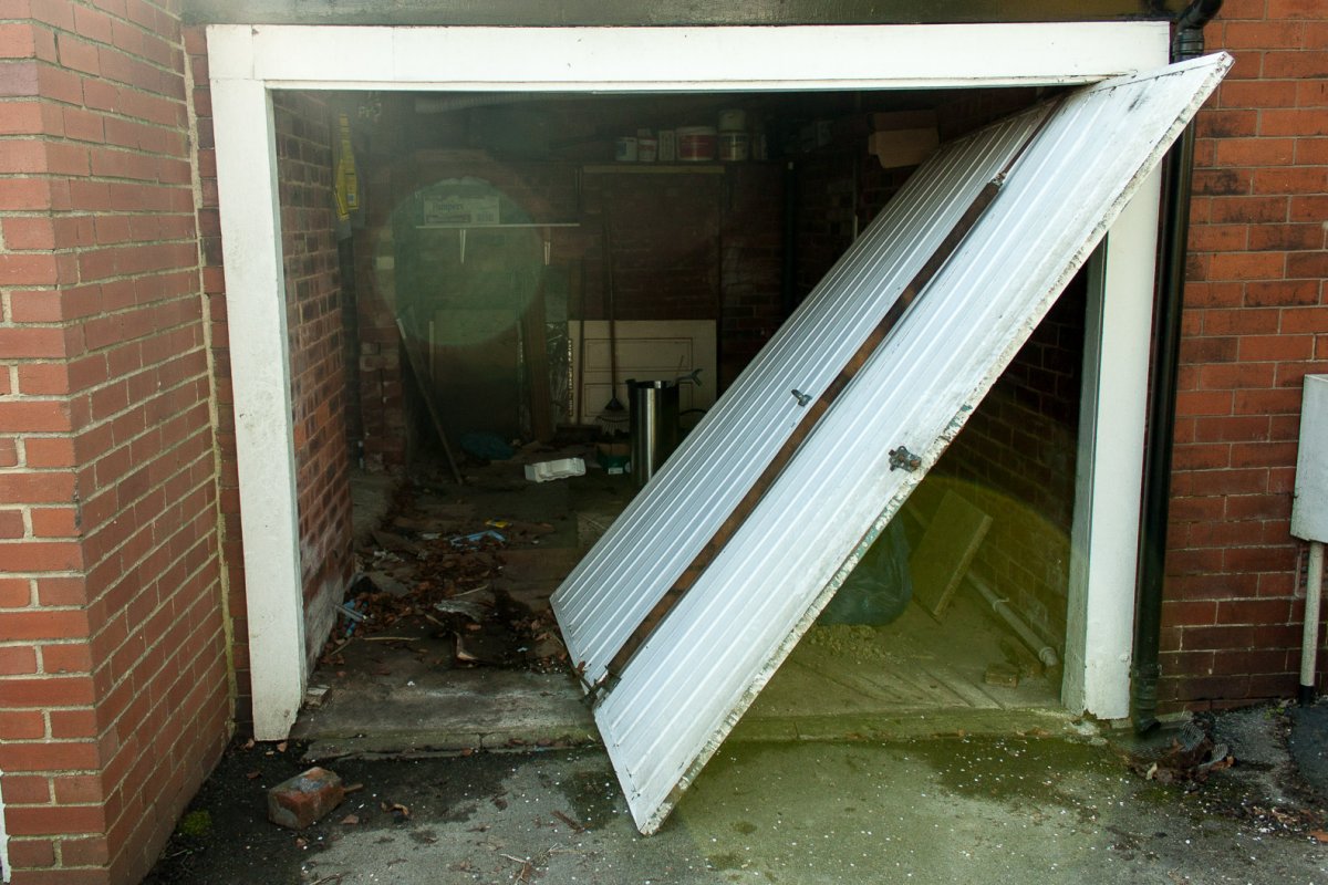

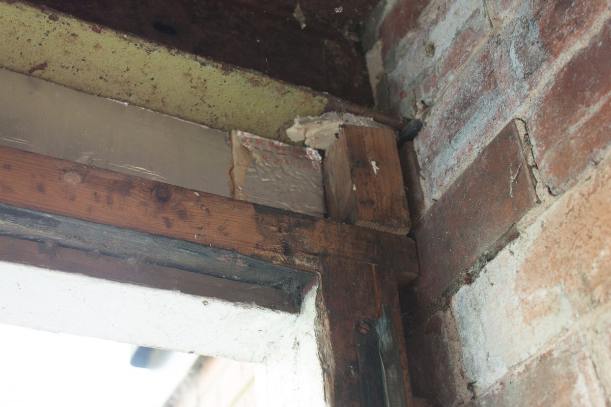

My garage door has come off it's mounting on one side. The screws fixing it to the timber baton seem to have twisted and split the timber and finally become loose enough to let the mounting come off.
How easy does this look to re-attach. I am a bit nervous about trying anything myself with all the spring tension involved.
Could this just be re-attached? A bit of wood filler, new screws and rawl plugs? Maybe replacement cables?
Thoughts much appreciated!
I just had to replace the cables on mine last week when they snapped, Exactly the same door by the looks of it.
This is the kit I bought if the cables need replacing http://www.ebay.co.uk/itm/331021017...49&var=540237916697&ssPageName=STRK:MEBIDX:IT
It also comes with the tension tools for making the spring safe while you work.
Here is the video I loosely followed (I also had to re-tension it which I figured out on my own)
I would use the supplied tension tools or find something strong to wedge through the holes (I warn you I did snap a really old rusty screwdriver before I decided to use the tension tools).
Then I would prop the door up and put some new screws/bolts through at opposing angles. You could fill and glue the old holes first if you like but you will have to wait for it to go off.
It is a bit of a fiddly pain in the butt job to change the cables but I managed to do mine on my own.
Quick note.
If you do change the cable/cones. DO NOT! Loose your old split pins like I did!
The new one supplied are tight as a mother F'er to get in, The old ones would be much easier.

Well, decided to get a pro to look at it.
Two options
1) Replace the wood frame (the exisiting one was a bit bodged to begin with and parts are rotton) and then re-use the exisitng door which (according to the pro) looks to be in servicable condition with just a few replacement parts required. Priced around £330 .
2) Replace with a modern up and over and an all steel frame. Price around £550.
I am normally a make do and mend. But an all steel frame does sound more robust in the long term.

True it would be.
If the timber frame is that bad you may as well go the whole hog.
I would recommend a retractable door rather than a canopy/up and over though as it would be easy to add a motor to it at a later date if you wanted.
You have alot of posts here so you must be quite handy. They are pretty damb easy to fit but to be honest £550 all in is a very good price!
It is a pitched roof garage, so a full retractable (I assume) would eat a lot of air space. I also assume it would also leave a permenant frame and motor floating in mid air.
