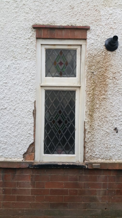

Hi.
I am having to swap this window for a new upvc one.
My issue is the lintel. The vertical bricks are supported by the window.
Can I buy a single steel lintel I can fit prior to taking the window out !? I.e a thin piece of steel?
The lintels I can find look as though the vertical bricks will need taking out and refitting !!
Any advice much appreciated.
I'm no expert (ie structural engineer), but have a reasonable understanding of applied loads and corballing(?)/keystoning in brickwork.
The narrowness of the window could suggest that no lintel is required, but!!... a floor joist could be anchored to the internal leaf right above it, even so, narrowness may again suggest corballing would push any load either side of the opening!
I would check with building control in your area... They are usually pretty helpful when asked and may pop out to you to have a gander.
Meanwhile, I find this an interesting read...
http://www.smithmarstonblog.co.uk/c...ing_wp_cron=1446910252.7650780677795410156250
That's a nice window, and part of the character of the building. I wouldn't call uPVC an upgrade...
