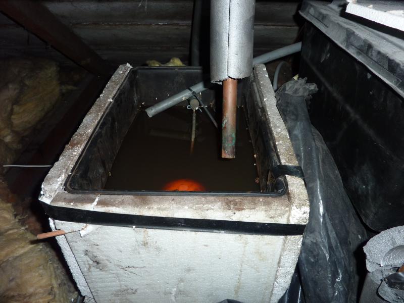

Recently the upstairs radiators have stopped heating up fully, the lower part of the radiator has some heat but not much. I have tried bleeding these radiators, initially some air comes out, then it stops and there is no water or air.

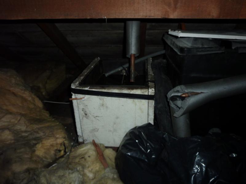

The smaller of the two tanks in the loft (I guess this is the feed and expansion, or fill and return not sure to be honest) has a lot of brown sludge in it, which is quite disgusting. The water level is above the ball cystern, and to be honest it doesnt look like it has gone below the ball in quite some time. Also I have noticed that the overflow pipe that is routed outside has started to drip, where it never used to at all.

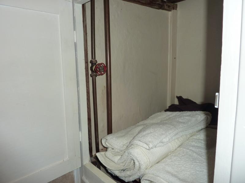

Have done a bit more research. There are two pipes that I can see coming down from the feed and expansion tank. The pipes come down through the airing cupboard. One pipe has a red turnable valve, the pipe is quite narrow, this pipe runs down past the hot water cylinder and then splits off into two directions, One direction goes into the cylinder and the other part feeds into the first radiator on the top floor.
The other pipe is much wider, it goes down past the hot water cylinder, then has a T junction where it looks like it goes into the hot water cylinder. The other part of the T junction goes downstairs, and I presume into the boiler.
When the pump on the boiler kicks in, I can hear a lot of rushing water and some air coming from the large pipe. The large pipe is quite warm up to a point, and then becomes cold the further up it goes. The small diameter pipe is mostly cold, apart from where it is very near to the split at the base of the cylinder.

Our landlord sent a plumber round to fix the problem. But it is not fixed. The rushing sounds in the pipes and the banging in the boiler have been fixed, and now we have one radiator upstairs that gets warm (not hot), this is the rad nearest the hot water cylinder in the bathroom. But the rest of the rads are stone cold. And we are still freezing in bed! (not to mention our poor hamsters in the box room).
The plumber took the valve off the pipe in the third picture below (in the airing cupboard directly below the f & e tank in the loft). This pipe is the cold feed, and the larger pipe next to it is the vent pipe. But the size of the gunk in the f & e tank in the loft was a lot lot larger than could ever fit down that pipe. So I doubt cleaning the pipe at the point of its valve would have done anything to dissipate the build up of sludge in the f & e tank.
I've been up again in the loft and taken a pic of the f & e tank up there. It looks to be in the same state as before. That is, full of water above the ballcock. So I am not sure if the problem is fixed at all. I'll post a pic of the tank. Any thoughts?

After the heating had been off for a few hours yesterday evening, I went into the loft to check on the feed and expansion tank, and it seems fine. Water level is normal (just enough to float the float), so as I understand it, if the water level is going up and down as normal in the tank, the cold feed must be free of blockage.
Anyway, after another freezing night last night (and my calls to the landlord unanswered) I am at my wits end. What could the problem be now? Is there air still in the system somewhere that is preventing the hot water from the boiler downstairs from getting upstairs? Do I need to drain the whole system? I just don't know.
The water level seems rather high. Does the pic show the water level in the tank when the heating water is cold or when it is hot?
You need to check the level when the water is cold (brrr!). It should be just high enough so the valve opens before the water level drops to the outlet at the bottom of the tank. Bend the valve arm to adjust the level.

It would be sensible to bail out the tank and remove all the sludge etc when you are checking the level.
Hi
Those pictures were taken when the system was hot. I have since looked when the system is cold, and the water level has fallen quite substantially, it is now about 6 inchs below the level in the pictures.
