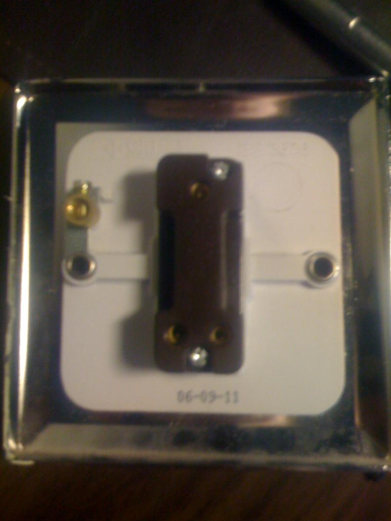

i was replacing a light switch in my house (only 8 yrs old) and come across three red wires connected to the switch, so i put them into the same places on the new switch to find that my wife hadn't turned off the mains, so when i wired it up the light came on, but shortly went off. i then found that the next door bedroom light is not working either yet all other lights in the house are, there is now no current travelling through the live feed so i do not know what to do, your advice would be much appreciated. sean

Can you take a picture and post it here. Thanks;.

Three red wires at the switch could mean that you have the live loop at the switch rather than at the ceiling rose. Or it could be part of a two way system or...the bulb could have blow and the wiring is in series.
How are the three conductors arranged at the switch?
How did you test that there were current going through the 'live feed'?
What is the arrangement at the ceiling rose?
Photographs would help - but please make sure the power is off and your wife is out of the house - with the doors locked - before you start undoing any switch covers.

Thanks for the pictures but how were they/did you arrange the conductors.
Were there two reds in the common and one red in L1 for example or was there one red in each of the terminals.

i put 2 reds into one terminal and the "live" in the other but have obvious doubts now to potentially getting the wires mixed up which i have no idea to how this could have happened but can be the only explanation:/
and no i dont have a multimeter :/
Assuming the room in question has one light, you need to connect the red that goes to the light in L1, and the remaining two reds in Com.
The two reds in Com are the feeds - that's feed in, and feed out to the next room.
Ideally you need a multimeter to find the wire to the light, and more importantly to CHECK THE POWER IS OFF. If one of the wire ends is doubled over this would suggest this in the one wire that goes on it's own.
If the switch appears to be working upside down, remove the wire from L1 and put in L2.

If the original arrangement was two reds in common and one red in L1 with the neutrals connected together then it is likely that you have the live loop coming through this switch and onto the next switch - with the switch live going to the lamp.
I take it there were no pieces of sleeving or other type of tape to indicate which was which?
Unfortunately without a multimeter it is trial and error - which I would not subscribe to.
Incidentally that looks like a metal switch - if so then you must make sure there is an earth wire from the switch to the back plate earthing terminal/other earth wires.
