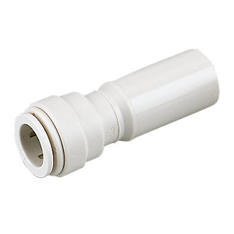

Can I simply connect 10mm copper pipe to the manifold and then convert to 15mm plastic pipe using a Speedfit Reducer 15 x 10mm?

Yes connect to manifold assuming you can get fitting that will connect to that manifold use reducer and then run your 15mm plastic
