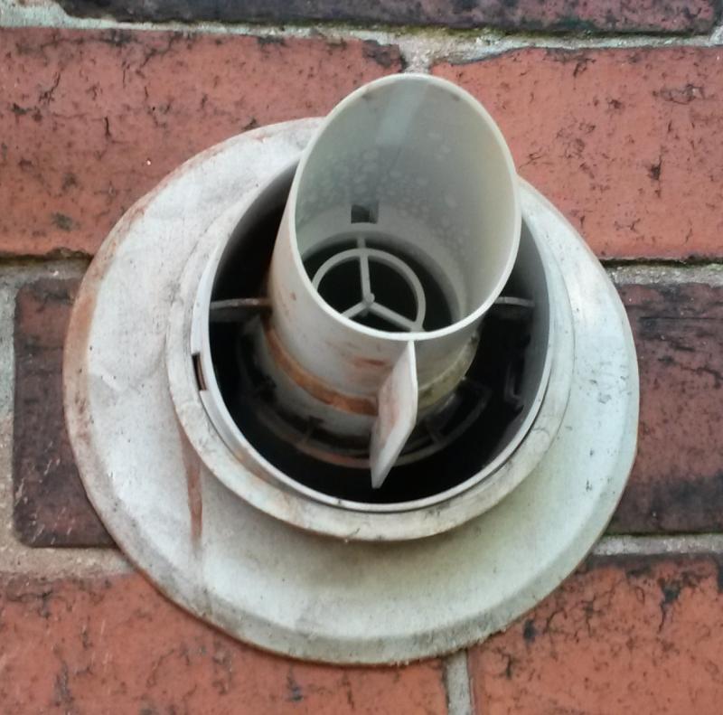

I have a Vaillant condensing combi boiler with a flue that comes out of the side of the house
however I am building a car port on that side and the extract flue is just below the car ports roof line and reasonably close to the structural joists.
So often the flue is discharging the hot damp air onto the frame and I want to move the flue away.

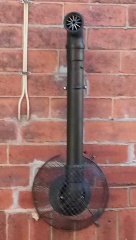

I can't move the boiler or it's extract through the wall but next door has a periscope thing on theirs which lifts it straight up about 2 foot which would be perfect for me.
This is my flue
This is my neighbors
So what do I need in order to achieve this?

Are you gas safe registered? If not, then you cannot legally do it yourself. If you do anything wrong then you are potentially causing the boiler to be dangerous. Not for DIY, I'm afraid.
For a start the boiler flue shouldn't be under a car port in the first place unless it has at least 2 open ends and is 200mm from the roof of it. If it doesn't have this then your boiler is already dangerous as it can cause a build up of fumes (carbon monoxide included).
Yes you must use Vaillant parts, it's not allowed to mix different manufacturers flue parts under any circumstances. It comes as a kit although extra bits can be added on if the flue length is calculated properly (another reason not to do it yourself).
Well the downside is that anything to do with gas or combustion needs to be done by a gas registered engineer.
It is also slightly questionable if the inlet can remain under a carport if the outlet is extended above it.

the flue is not under the car port, yes that would be silly.
the current flue is level to the top part of the roof and 6 inches outside it
but that is still too close imo and the steam occasionally blows onto the outer most joist
the car port is also still under construction and there is no roof on it but I am thinking ahead to when it is roofed in a couple of weeks.

The wisdom of Google tells me I need a plume management kit.
