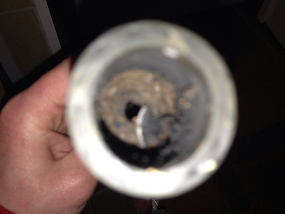

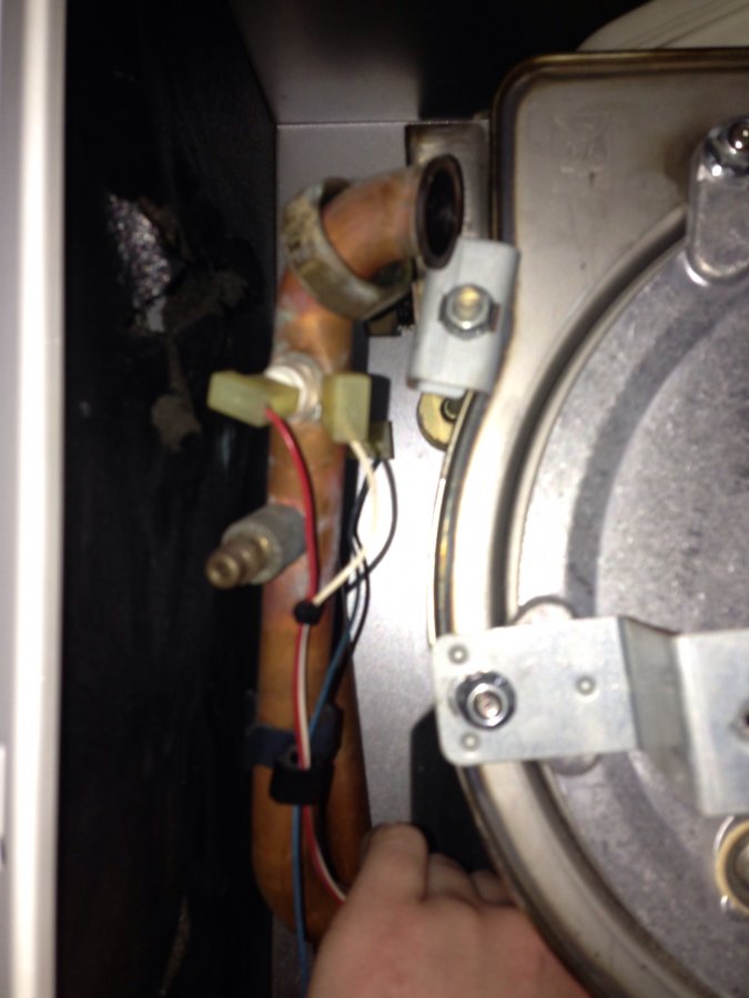

I had an issue like this a while back only my water wasn't getting very hot when opened taps fully on our vailant eco max 824 a rubber pipe was blocked. It caused the boiler to make hell of a racket lol vibration noise. Had my so called mate to try and fix it from British Gas, changed heat exchanger , pump , then he cocked the board up replaced that also poweflushed system which was very quick 2 hours tops. In the end he left me with no hot water or heating as the 2 x 22mm inlet outlet pipes he turned the isolation nuts and rounded them off. So told him to go then I bought that short length of rubber piping for around 10 pound and that was all it was fitted that was gutted i didn't do that in first place . Was without boiler for 4 weeks in freezing winter
