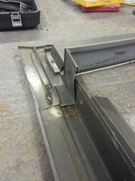

I've purchased a Velux window that came with an old flashing kit. It looks like an EDZ to me - can anyone confirm?

You are missing the foam splash suppressors also so throw that flashing kit away.

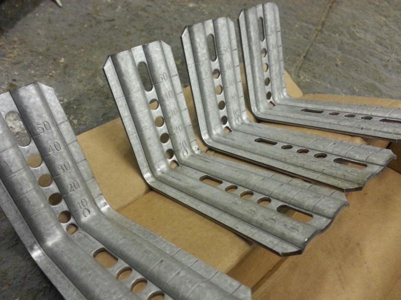

I have two boxes of corner brackets with them, but I've no idea what to do with them because they don't look like the brackets that Velux have on their PDF's:

The flashing kit will not have any corner brackets.
As i have said, there is a dedicated slot or slots into which the corner brackets sit, which allows the Velux to sit in a predetermined position relative to the height of the roofing battens and tiles.
The brackets are positioned in such a way that the Velux is 'submerged' slightly below the level of the battens, leaving a certain amount of window showing above.
You need to suss this out prior to fitting the corner brackets and don't fit them in a position that is likely to interfere with the flashing kit later on.
The Velux brackets sit on dedicated roofing battens that are positioned relative to the top edge of the last course of tiles (measured 80mm up) at the bottom of the window. The top batten is positioned the length of the window plus 45mm up from the bottom batten.
