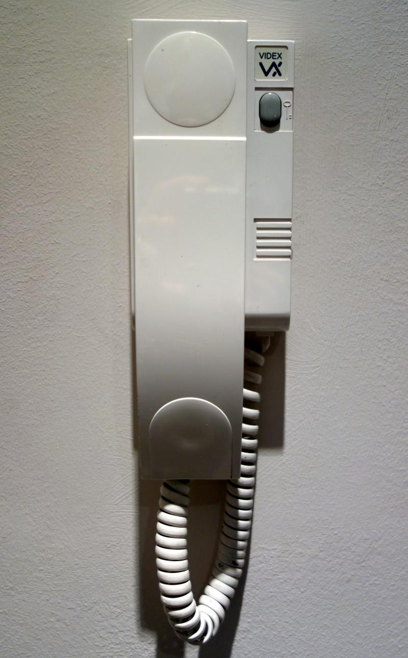

Hi, my Videx intercom handset has stopped working - the speaker/mic/lock connection is fine, but the buzzer had broken. The connection is fine, just the physical part of the buzzer shakes itself loose and can't be fixed.
The flat's management company has quoted me £200 to replace the handset, which seems steep given they're about £20 online!
If anyone could help me identify what Videx system I have and what would be a compatible replacement, I would be very appreciative.
I can't seem to find an exact replacement online, I guess it's very old. I can't see a product code on the device. I have looked at something like the Videx 3021A, but just don't know enough about these things to take the plunge.
Pictures below, please help!
It's a smart 1 handset 3021 and I would agree that it just needs the buzzer changing.
Fantastic, thanks for such quick replies both, that's really helpful information!
