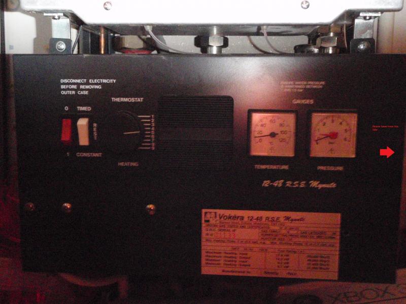

Can someone tell me if I am doing something wrong. My vokera boiler lost pressure so i managed to top up the system to 1.5, but I can't get the boiler to light
I have switched the boiler off at the wall left it for a long time (even over night)
set the mode selector switch to constant
the thermostat dial to max
then i put the power back on at the wall, set the timmer controls to on for water and central heating
then i put the power switch on but nothing happens
please help can't get a plumbing out until Monday at the ealiest

possibly overheated, overheat stat is located on the right side behind the black control panel. you will need to take the white outer case off and push the button to reset it.

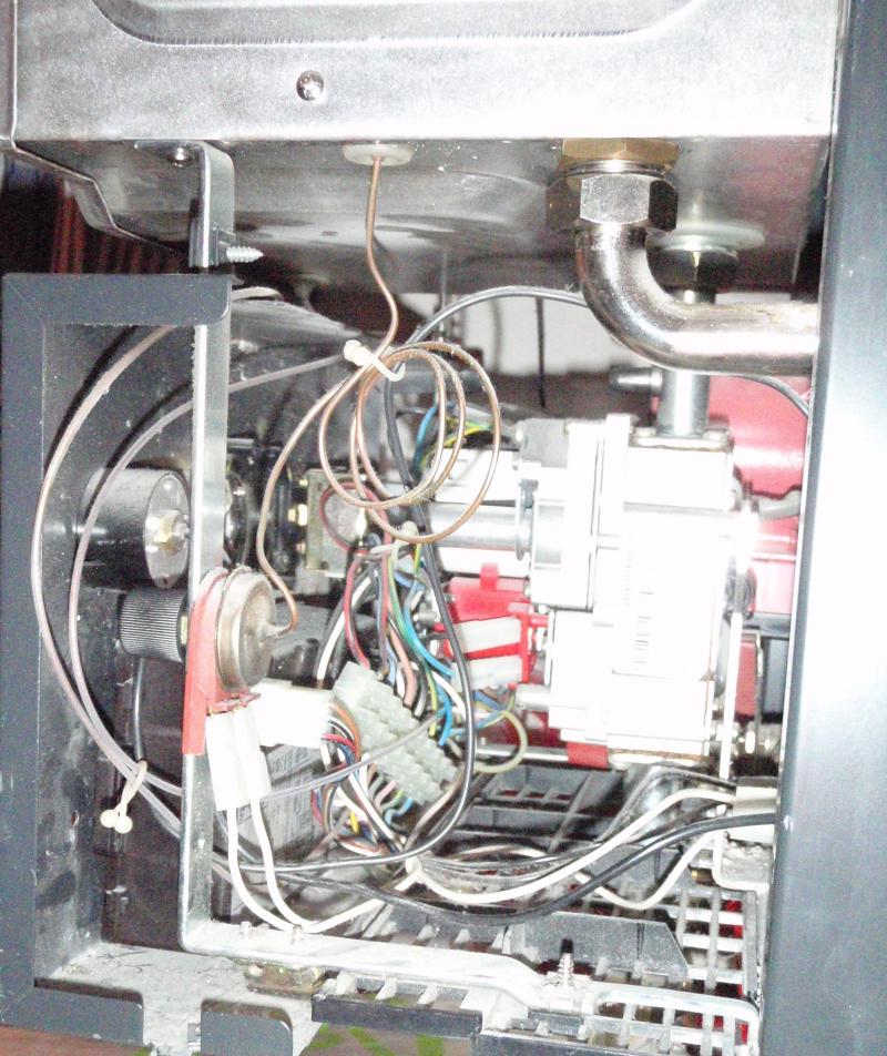

I have the same problem. this is what the engineer said he did last time but I can't find the reset button! can any one help?
take the white case off and its on the right hand side attached to the chasis with a little button on it that will have popped out

I already had the cover off but can't find it. i have taken a picture of the right hand side, can you spot where the reset button is? is it part of the black junction box at the bottom left hand side of the picture?
Circular thing on lhs of pic attached to chasis as stated withe the White wires coming out of it.it had a little button on it just press it,after you remove that black cap hahaha.screw the cap off mate
