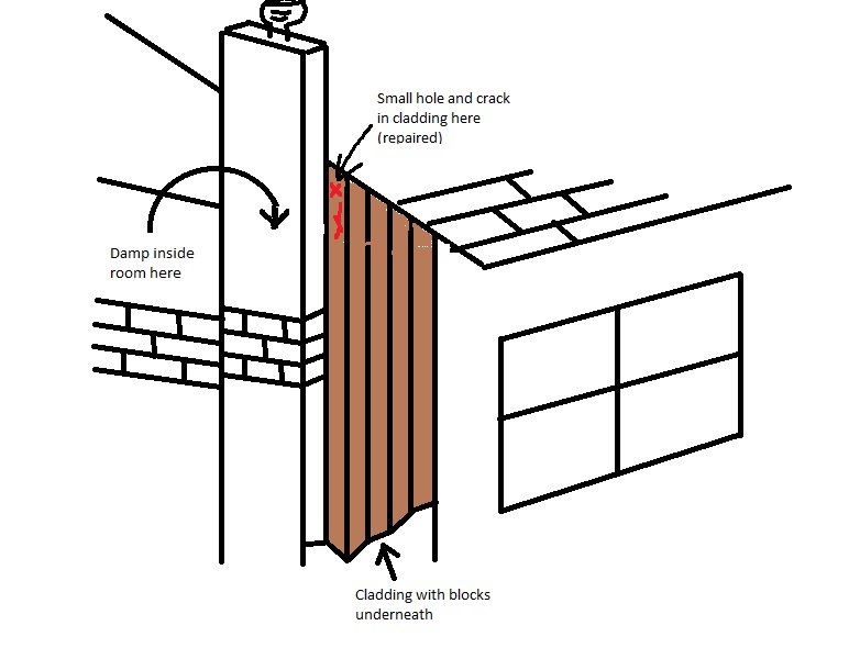

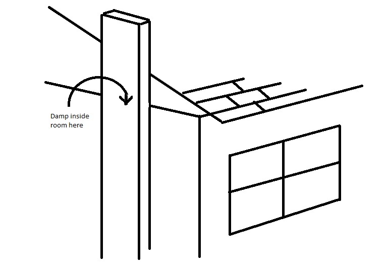

As you can see from the layout pic, the most obvious place is water coming from the chimney flashing but I've been up there and checked and I can't see anywhere water would come in from.

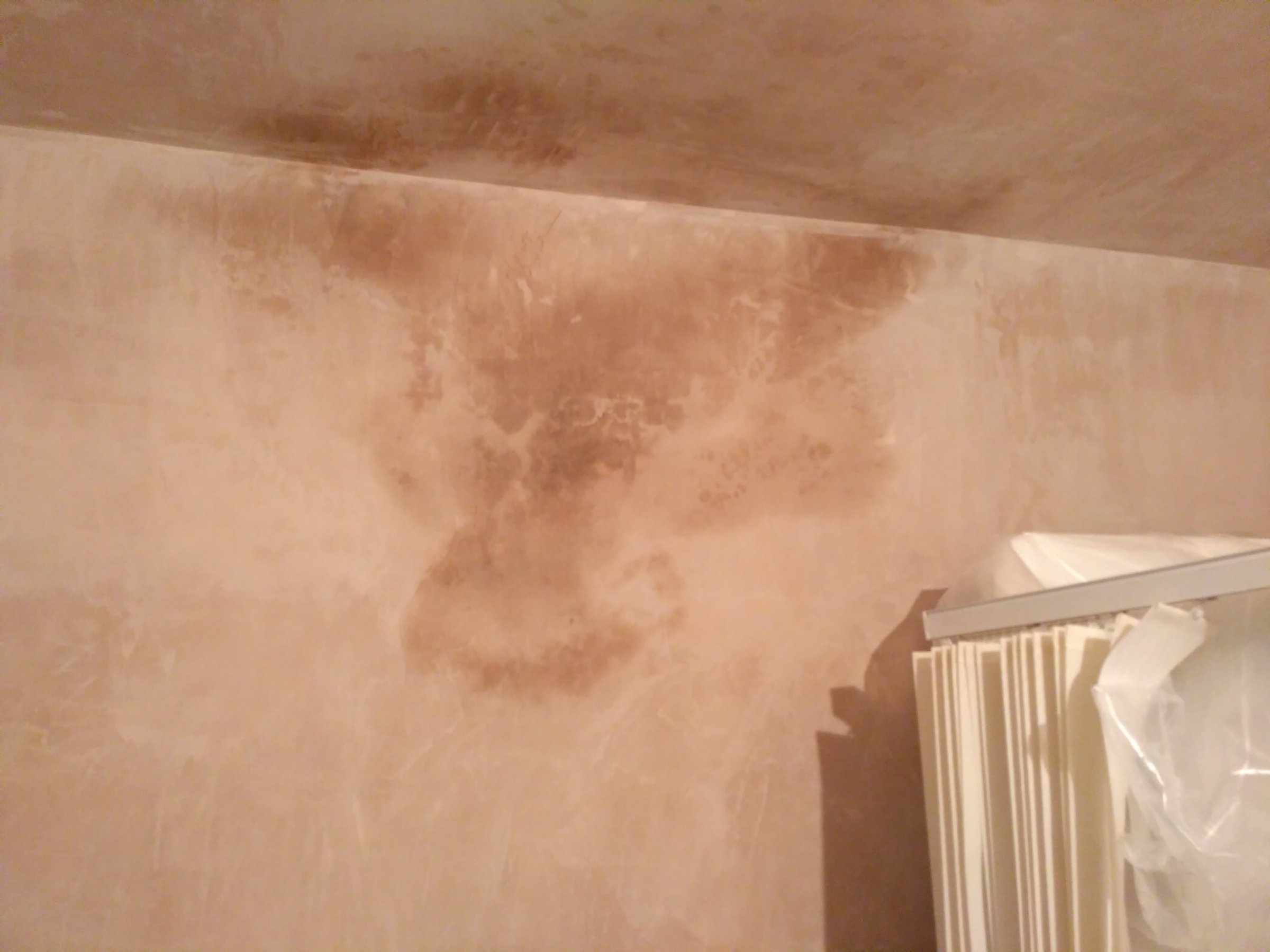

Am planning on taking off the wall plaster soon and see if the wall is damp behind it (probably). I have a tester and is around 33% or so at the join with the ceiling and is about 1m sq patch (although is semi circular in shape).

Hi - having put in the Dryzone and some water seal on the chimney, the plaster inside is showing as 25% on my damp meter (from previous 33% as mentioned originally - been measuring same place).
The boiler has now gone so has to be coming from roof, as thought.
I might get the wall boarded up and skimmed (removing old plaster) but don't want that to be damaged so my question is - should the plaster dry out totally in which case I still have a leak?

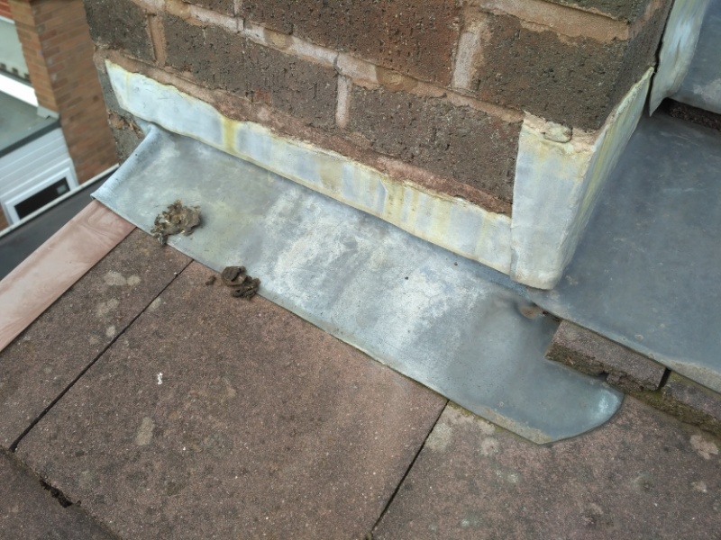

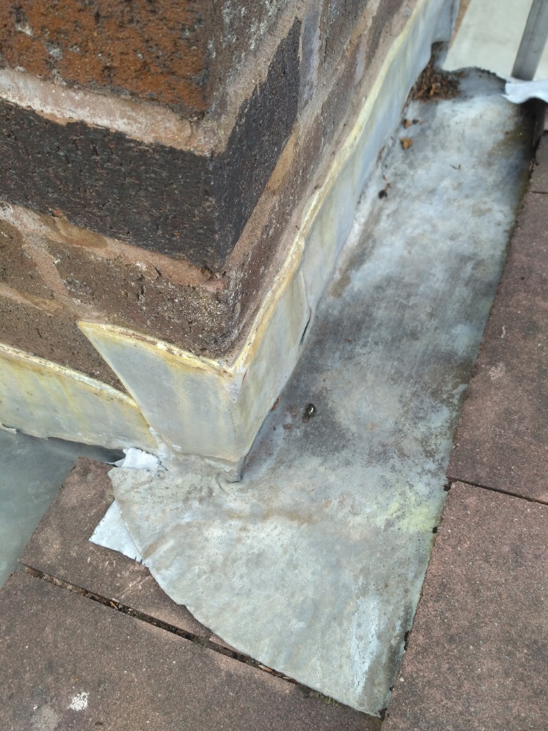

Some pics of the flashing and also one of the wall which has some strange mortar, kind of bubbling and crusty? from the drawing i did of the outside (2nd pic, post 1), this just to the right of the 'e' of the word 'inside'

If that was a problem caused by no DPC in the chimney, then it would have been damp from then it was built.
If it gets wet after rain, and has yellow or brown stains, then its a flashing defect.
If its damp almost all the time, but not spreading, then its a flue issue
Once wet, plaster salts cause misreadings on damp meters
Thanks Woody. I reckon it was a flue issue then from your comments.

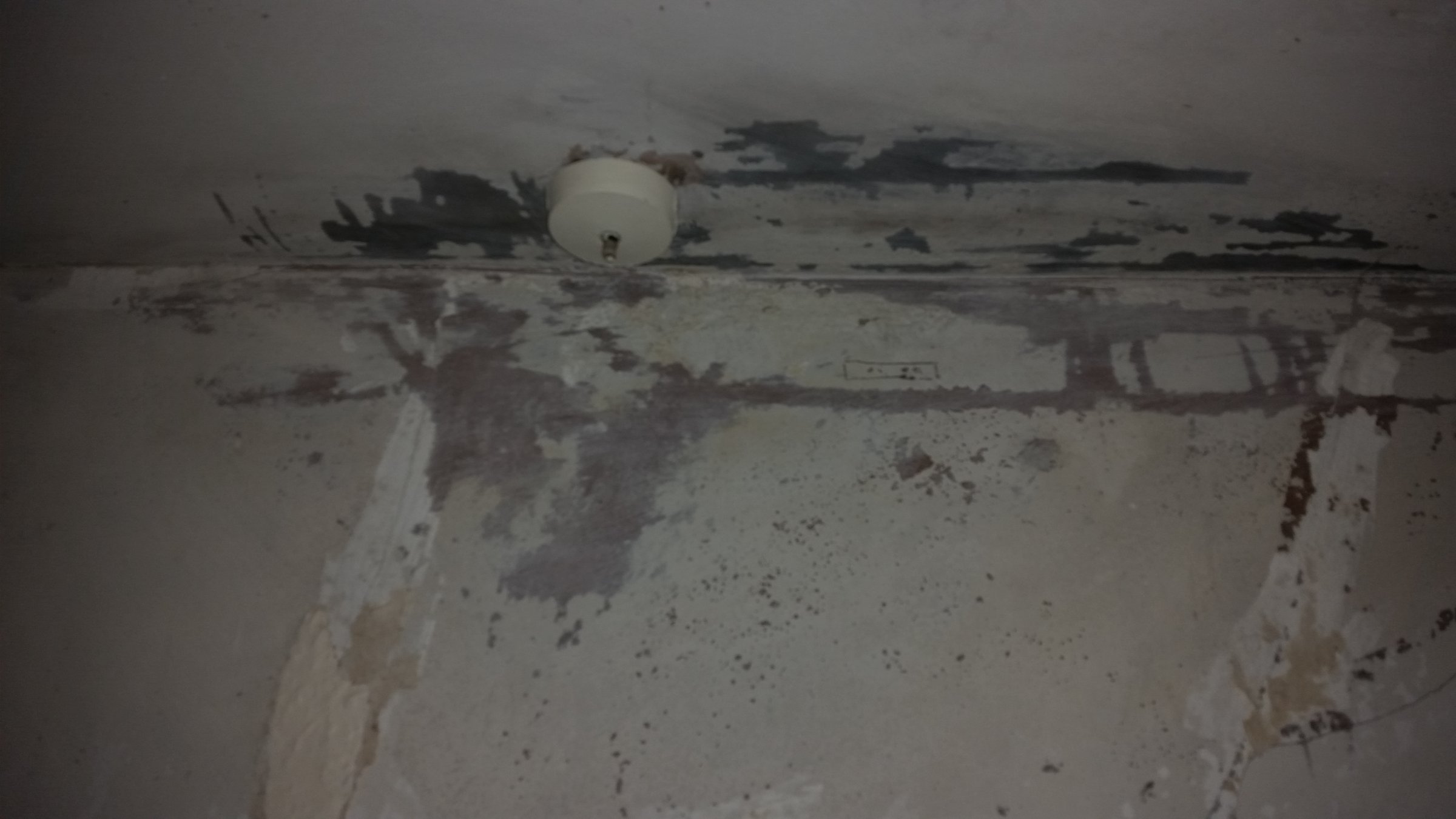

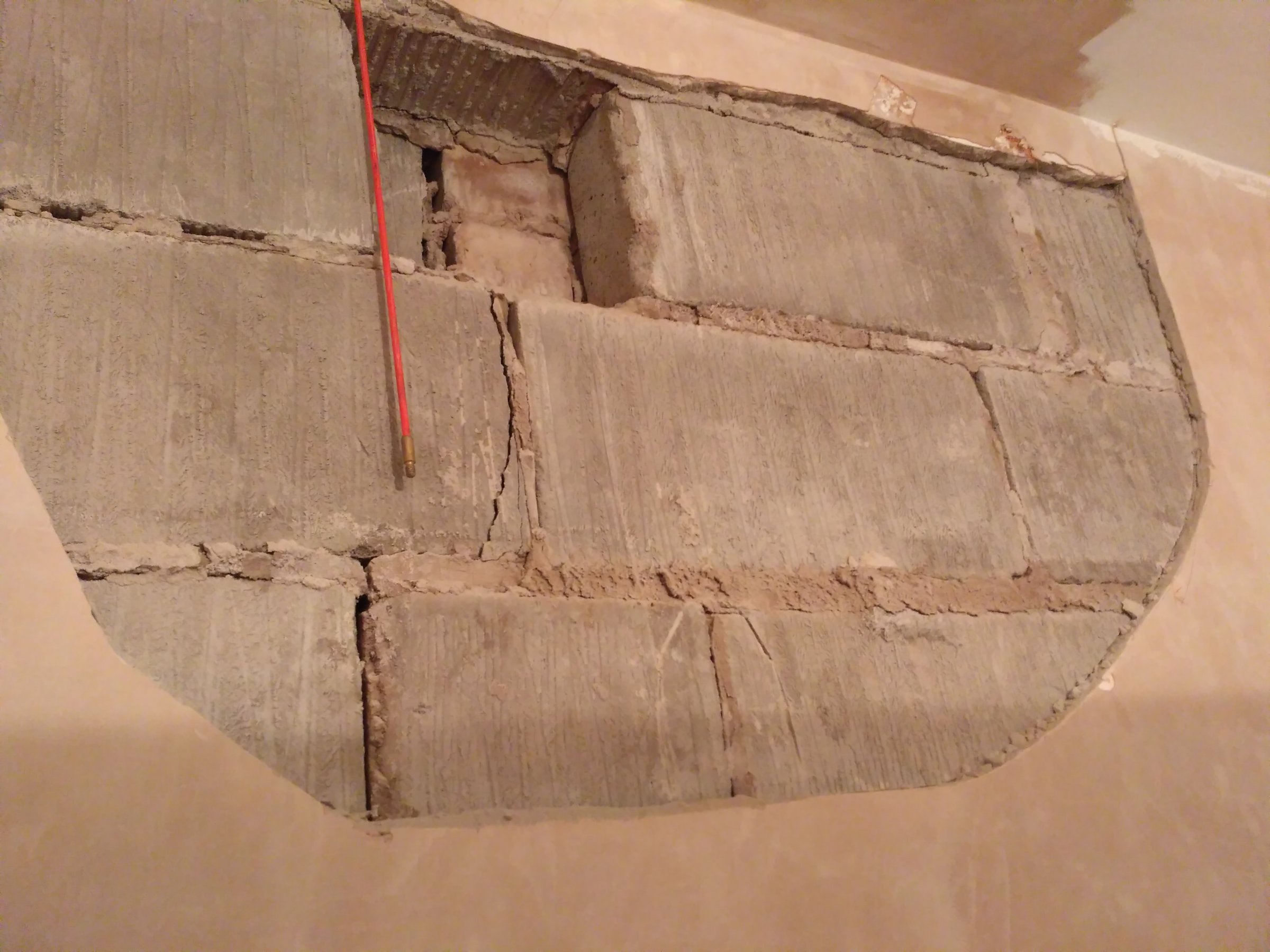

We had whole room reskimmed and against my better judgement, I decided that the plasterers knew more than me about what to do so left them to it. Sure enough, this patch hasn't dried out so have chopped it out to see what's happening.
The bricks show the chimney (outer skin, just to right of red rod) and where that red puller rod is, there was a bit of a crack which led me to fix the wooden cladding which (as you look from the inside) is left of the brick chimney covering the breeze blocks, brick is the outside skin of the chimney and also to the right of the chimney. Not sure if this is the cause - possible that even a small gap in the cladding would lead to this? Has been filled anyway.
I was thinking it was more chimney as the centre of the patch lines up with it but not so sure now. Have a dehumidifier going to see if the blocks dry out - if they don't, i'm all out of ideas!

It's either the 4th wall that didn't get done, or the chimney needs capping, but it is possible that the wall was so damp, that it's going to take time for the breeze blocks to dry out, but tit could well be the hole in the cladding. You're going to need to investigate further.
thanks for reply.
I did do the 4th wall on the chimney.
Also, the blocks in the loft above this damp patch don't seem to be damp from my reader - they are pretty much the same as other blocks on the other side of the house.
There is salt showing there so am wondering if there was a fairly major leak in the past prior to us moving in which has been fixed, so this is prior damage to the wall and the current damp IS due to the small crack in the wood cladding. If you look carefully at the pic of the flashing on the chimney, you can see some of the mortar is different so might have been patched up to fix the problem.
Thinking I have 2 problems, 1 is fixed (chimney/flashing leak) which damaged plaster and blocks in loft show damp. And the other is due to the cladding crack which I've also fixed.
As I say, if it doesn't dry out now, I've no idea (and don't really want to pull the cladding off unless I really have to - not sure I can take it off without damaging it).
