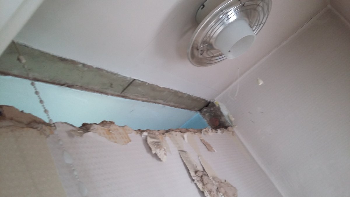

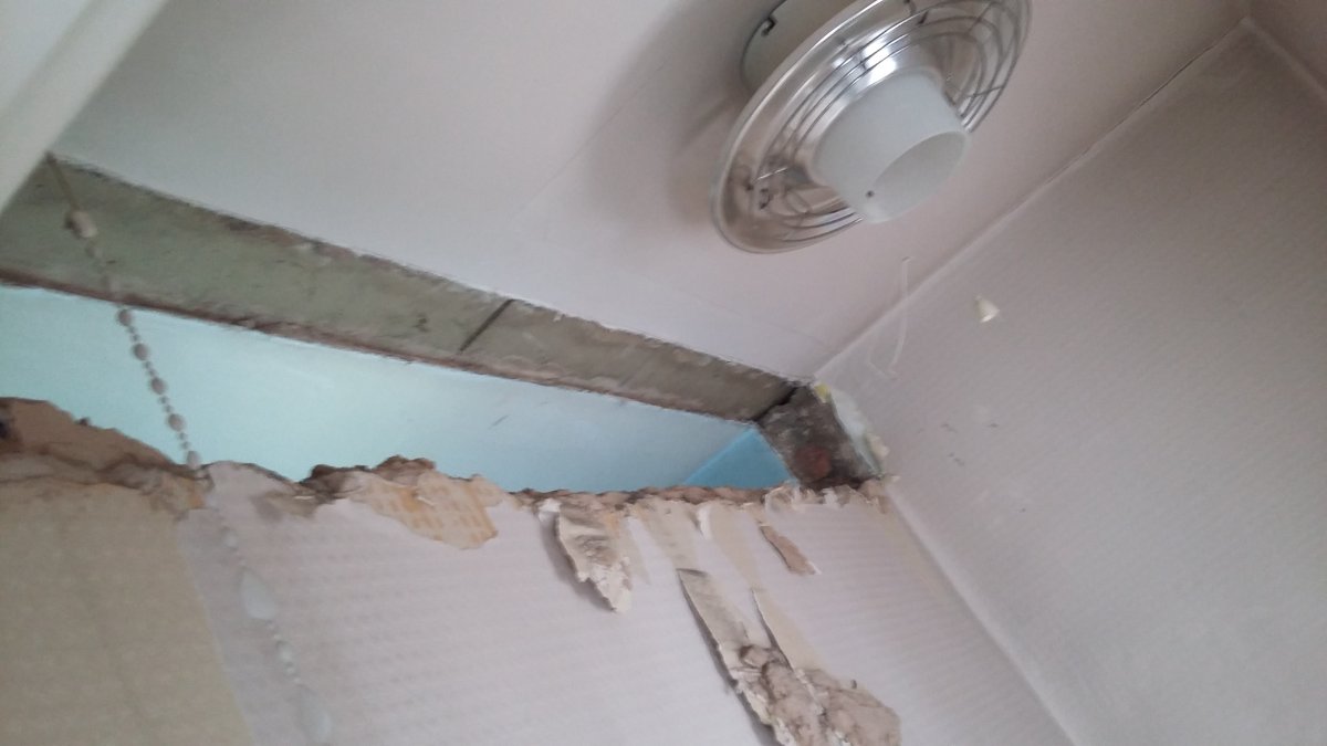

Those wall mounted heaters people have in bathrooms are pathetic. I did take one of those circular heater/light things recently. Looked like a bit of a widowmaker to me
As per the quoted regs, they should be mounted out of reach from a person using a bath or shower.
Arm' reach was in the definitions in the 15th regs, but in true perverse IEE fashion, the distances were not in that definition. 1.25m horizontally or 2.5m vertically.
