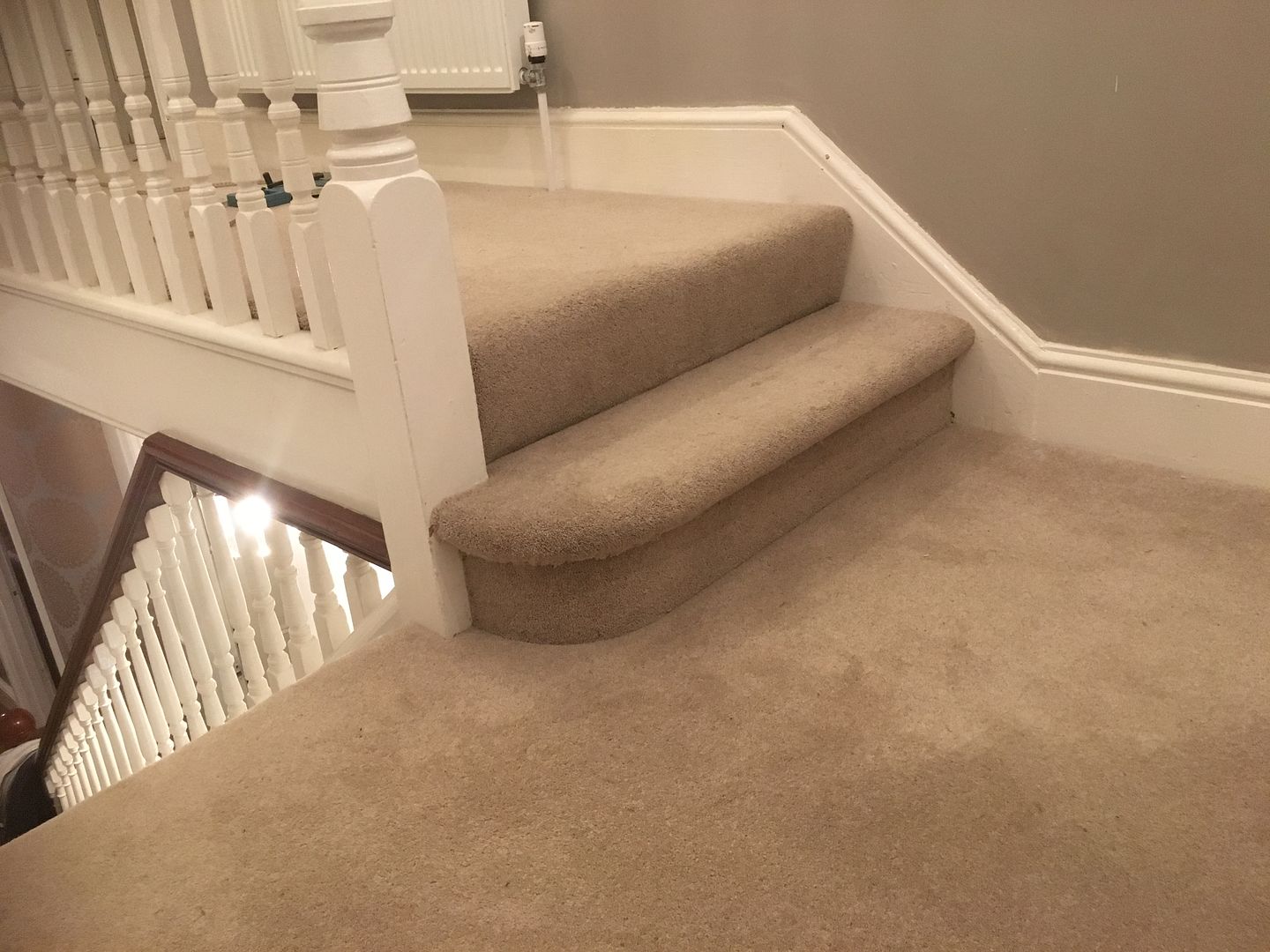

Can anyone help me with this drainage question. I want to relocate my bathroom to the other side of the house. Ideally I don't want to have to use a macerator incase it fails.
Only problem is, if I run a normal waste pipe between the floor joists I have this step to contend with.
If I somehow manage to fit 2x 30 degree bends in to drop the pipe down about a foot onto the lower landing level, is this going to create problems with the flow suddenly speeding up down the drop and solids getting jammed?

That part won't cause problems - the length of the run is more likely to. I assume a WC included in the bathroom. Can you do a sketch plan with rough dimensions (y) and where you intend to terminate the pipe.
Worth noting that the max length run of 1.5" waste according to Building Regulations is 3 metres. You can go to 4 metres if you increase to 2"
dont run waste pipes through joists, along is fine. best solution would be to install drain outside to new bathroom postion.
I read this as the OP wanting to put a 4 inch soil pipe under the floor. I would be investigating how easy it would be to install a new soil stack on the other side of the house.
