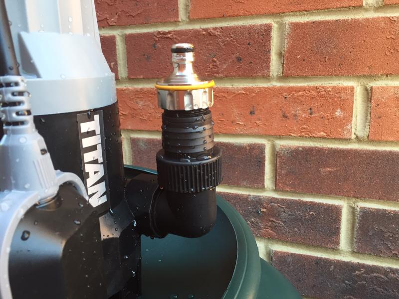

I have also just been to Screwfix and bought the £40 Titan pump (thanks for the recommendation) but I'm wondering what hose you run off the outlet?
It only seems to take 1 inch or 1.25 inch hose. There is also a 32mm thread that could be connected to... What adapter would I need to fit ordinary 1/2 inch garden hose onto the outlet?
Actually think I just worked it out, I'll need a Hozelock 1" BSP tap connector, will get one tomorrow.

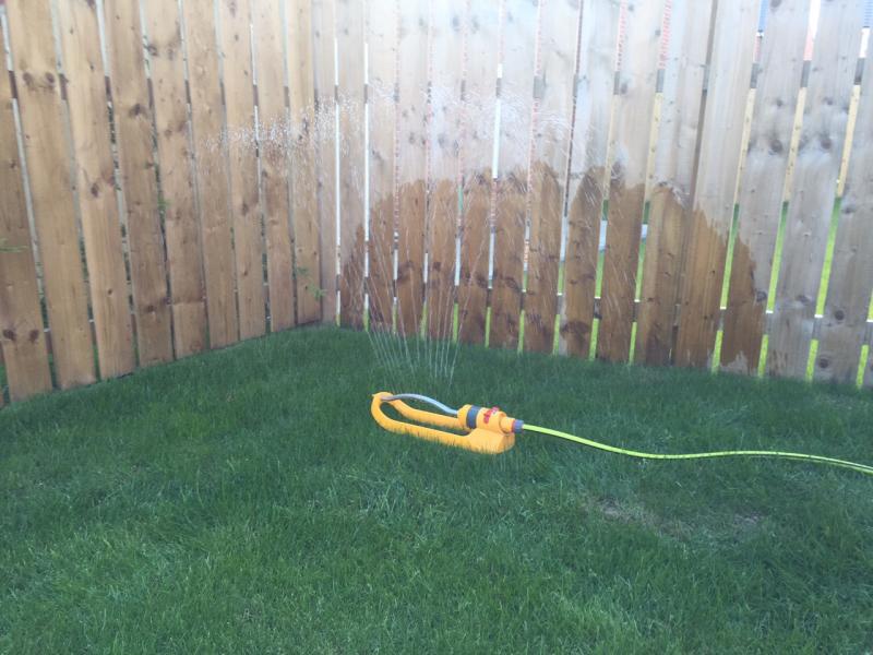

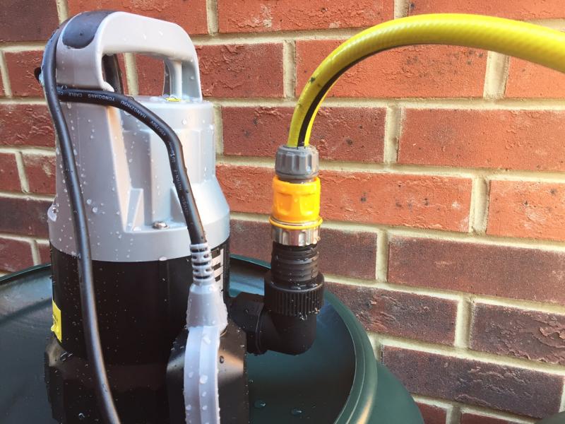

ok, either I've done something wrong or I've bought the wrong pump. :(
Hooked it up tonight, just using ordinary garden hose. However the pressure / flow (not sure which) isn't really good enough. My oscillating sprinkler only covers an area of about 6ft x 4ft!
Here's a few pics:
Any ideas?

Sorry this isn't working for you, and I don't really understand why, except I'm using 22mm hose, not 15mm. Maybe the small bore of the hose is causing too much pressure loss/restriction. The pump and sprinkler are the same as yours.
Could you try it with just a very short length of hose and see what difference this makes?
If you use the pump against a closed valve it will tolerate this for a short period, but it's likely to start overheating if you leave it like this for long periods, so best avoided.

The smaller hose could be the problem, so I'll try larger hose.
What fittings/connectors did you use for 22mm hose? Hozelock don't seem to do them?
Thanks again
Sorry for the delayed reply. I use Geka couplings, not Hozelock fittings - I have a commercial horticulture background, and these are an industry standard - just Google images 'Geka couplings' and you'll see the type I mean.
