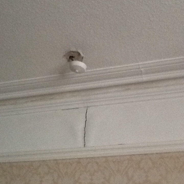

Can anyone see from photos where water is coming in down wall into bedroom & into light fitting.

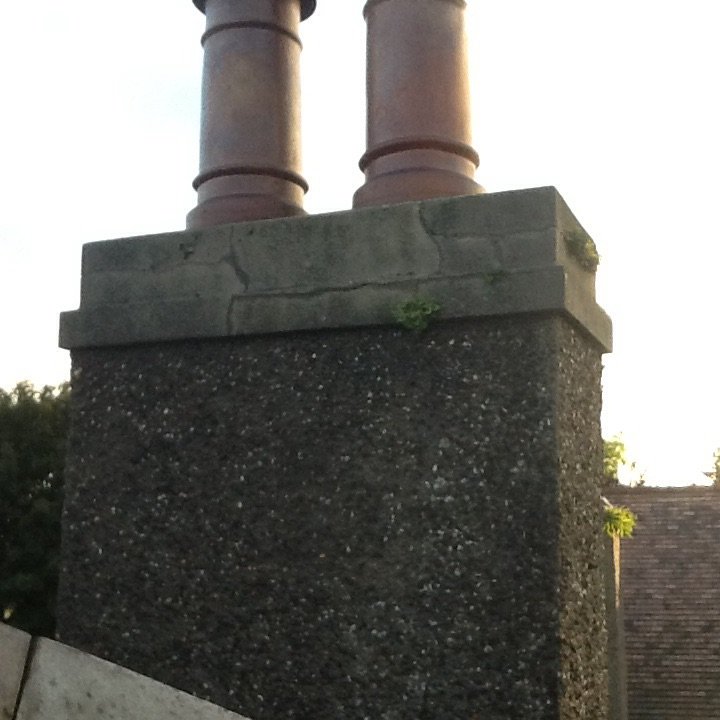

5. the pots are set on or set in what looks like a smooth rendered cap to the stack - two cracks can be seen and vegetation is growing around the cap ledge. The ledge could be holding water as could the flat top of the stack. Can you do a pic of the top of the cap?

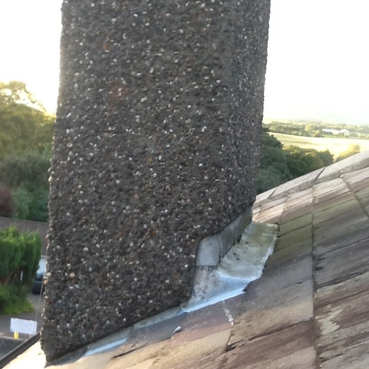

6. There should be stepped flashing at the sides of the stack - perhaps there is & its been covered by the dashed render. Its difficult to tell how its been flashed.

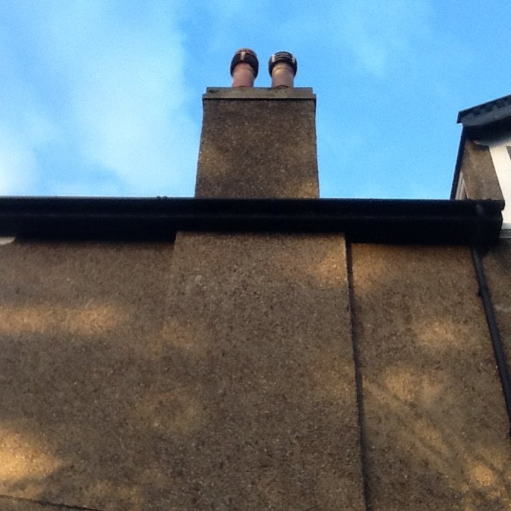

8. looking up from below in pic 6. any signs of water penetration on the soffit?

1 Noticed the water after after heavy rain recently when it came into our bedroom & tripped the electrics by running into the ceiling light switch but the crack in the wall has been there for a year.

4 The wall surface on the room below is damp.
5 Will try to get a pic of top.
Lots of slates repaired as its original roof from 1907 & can see no damage behind soffit.

Still waiting for a pic of the stack flaunching?
