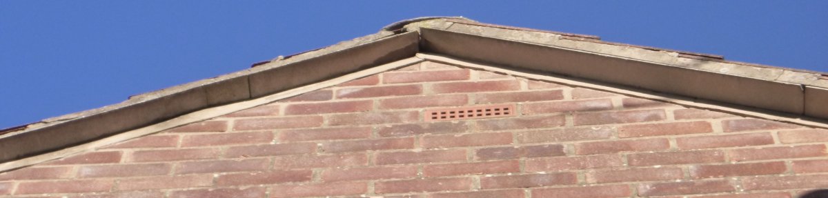

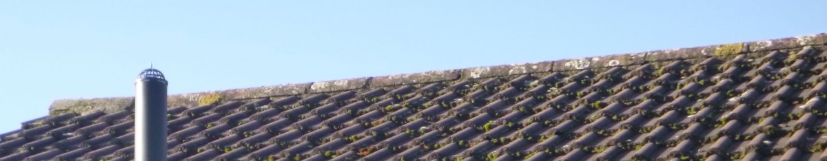

Good question, 3 things really, the main thing was that various lumps of mortar have fallen out over time, particularly at the ends of the verges and also from the ridge tiles. At the left side of the property is an area I would like to convert into a lean to shed, which will make future access to the verge on that side more difficult so I was wanting to make sure it was sound before that change.
The other thing is at the back there is a conservatory which makes access to maintain (paint) the facias difficult, I asked a guy to paint them and he suggested changing to plastic instead as without scaffold he couldn't get to it.
Oh and there is no bird mesh so we get birds and bees/wasps in the roof
Looking at the cost I'm thinking it might be better to try another painter and just patch the bits of mortar that have come out!
thanks

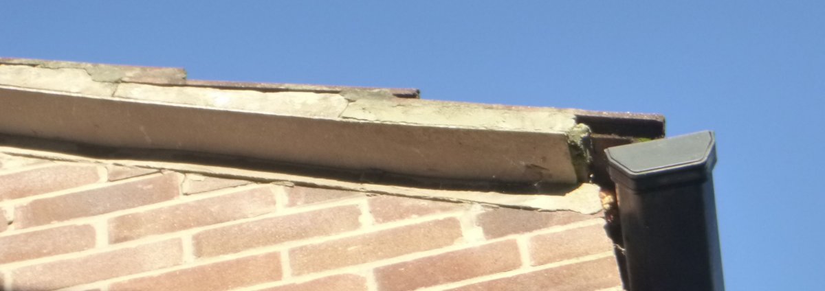

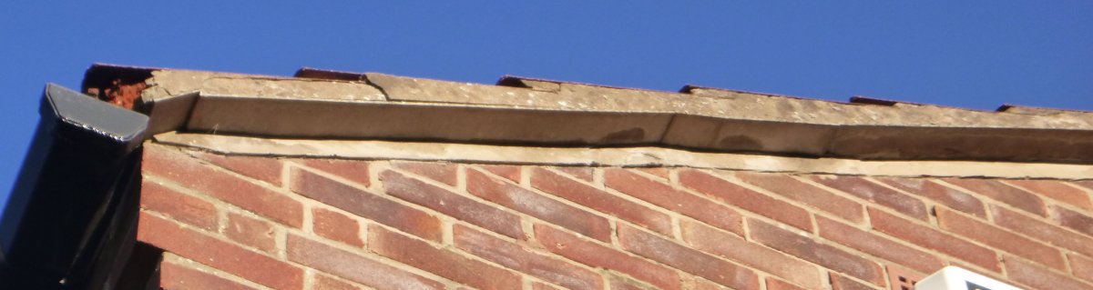

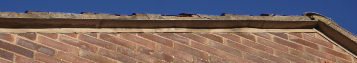

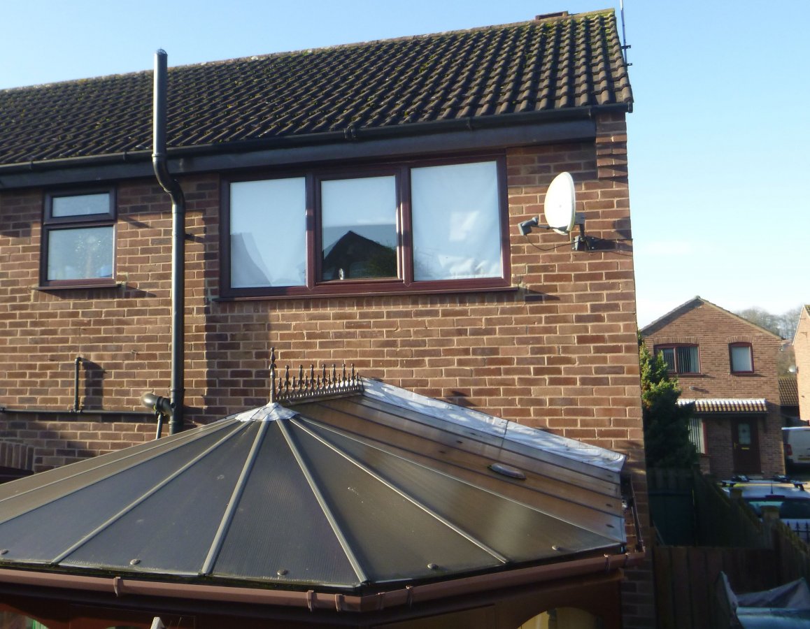

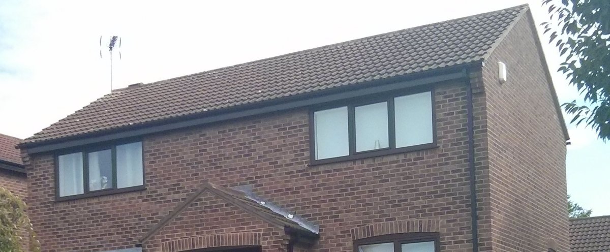

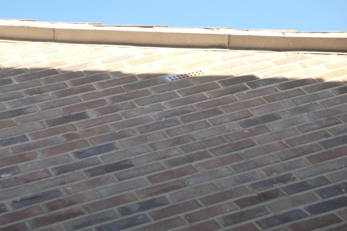

At last, daylight and a working camera! as can be seen, the end of the verge and the end of the ridge have lost morter plus there are cracks along. the ridge has had bits of morter slip down onto the tiles over time but it's difficult to see where it's from. the conservatory is an issue with access to the soffit/facia and for adding bird mesh :(

It looks like the verge has been badly replaced in the past
It also seems like too much of an overhang for a typical dry verge, and might need to be adapted (?). Normally, the plastic continuous verge or sections have to sit up against the wall or a barge board below the tiles. I am not sure if there is a system that allows for that much overhang.
