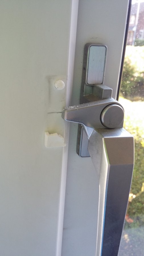

What are these? Can they be replaced?
15 Apr 2005
16,510
265
Yorkshire
Little plastic packers on upvc frames. These have disintegrated. The windows need to last a few more years yet.
Striker wedge plate. Found it. But dont know what size. Will have to measure one of the plates still intact.
Yes measure the stack heights. Ebay is cheap for them.
Also try searching for cockspur wedges
